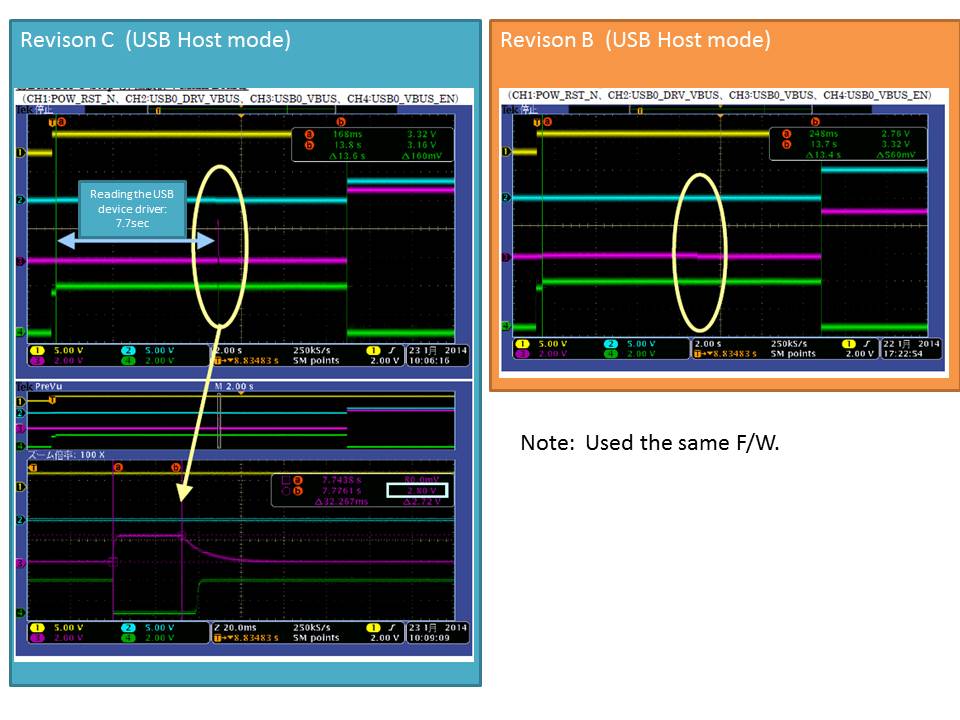

When they had used the revision B, there was not any problem for  USB (Hsot/Device modes) behavior.  However, even though they used the same USB driver which supports Host mode and Device mode with using Revision C, the DM8148 could not work correctly in case of Host mode.
  Note:"not work" means that DM8148 could not mount the USB device  And in case of device mode, there is not any problem for USB behavior.   If change the USB  driver which supports only host mode, there was not any problem for USB behavior.
According to them, the pin of "USB0_VBSUIN" was outputted the voltage(Approximately 2.8V) even though this pin type was "input pin".  I got the USB pins waveforms which the both cases Rev C and Rev B from customer. Please check them.
And If you need their schematic, please let me know. This documents is under the NDA.

  • Hi Pavel,
    Thank you for your response.
    I reported your comments to customer.  I have a question for USB controller behavior.
    [Question]
    What is the reason why the USB0_VBUSIN was outputted the voltage even though this pin type could be only  define as "input pin"?
    Do you have any ideas why this phenomenon was occurred?

  • Kaka,
    Kato Motoki said:
    [Question]
    I suspect this should be hardware design issue. Please double check your hardware design. You can use as reference the DM814x documentation (TRM, datasheet, SiliconErrata), DM8148 EVM reference design schematics. Have a look also in the below links:

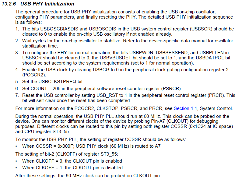

    By the way, does this device have a USB setting sequence(Initilazation of USB core) in order to use USB function?
    I read the TRM and TI wiki but I could not find out this sequence.  So, if you know this, please let me know.
    Kaka

  • Hi Pavel,
    I think that this is a general sequence by using USB function.
    I would like to know the unique initialization sequence for each devices such as below.
     Note: The following sequence is C5000 family.
    If you have any questions, please let me know.
    Best regards.
    Kaka
  • Kaka,
    I can find the below USB initialization sequences in the DM814x TRM:
    chapter 25 USBSS
    25.5.8 Clock, PLL, and PHY Initialization
    25.8.6.1.1 CPPI DMA Scheduler Initialization
    25.8.9.1.1 Transmit Initialization
    25.8.9.2.1 Receive Initialization
    Pavel
