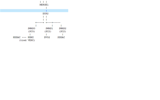

In our case,we want to use HDCOMP port on-chip, but we don't how to config it.

    i have alread find out how to display video from HDCOMP, I modified some registers ,such as 0x48140894 0x48140898 and 0x48140724.
    but in our case , wo want to dispaly vedio in three defferent ways, HDMI, DVO2(off-chip HDMI), HDCOMP(tied to DVO2), SDTV. I've modifed usecase VSYS_USECASE_MULTICHN_HD_VCAP_VENC, shown below.
    it can not work, here some debug info:
    [m3vpss ]  5624: Assertion @ Line: 1134 in links_m3vpss/display/displayLink_drv.c: pObj->displayHndl != NULL : failed !!!
    is there something wrong, i need help.

  • Hi zhao,
    In the diagram, it looks like input path is connected to the HDMI and HDCOMP, but you are trying to tie DVO2 and HDCOMP, this could cause display driver open to fail. You have to change the display controller try to connect input path correctly. Please refer to the links_m3vpss/system/system_dctrl_common.c file to get more about display controller tree.
