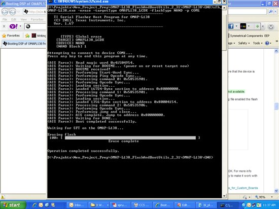

  • Hi Titusrathinaraj,
    Thanks a lot for quick reply.
    As mentioned by Sknakari, I tried erase command, and it seems my NAND is not accessible to me!! As I am still getting waiting for SFT...
    So I am working on that issue simultaneous. Will come to you on this issue in couple of days, as I need to look into my hardware & source code to make required changes.

  • Hi Prajakta,
    We received your source code and thanks for the update that the "SFT hang issue" gets resolved by modifying SFT source.
    I have ensured that your DSP app ( the source code which you sent) gets waken up successfully through your ARM code.
    I have confirmed this by just introducing a led blink in your main function of dsp app. Please refer to the modifed source code sent via Hemraj.

    I have noticed a "Read error" in the screenshot sent through Hemraj while your flashing ARM & DSP app code into NAND flash.
    As already communicated with you, before flashing code into NAND flash, please confirm that the NAND flash device is available to do the 'erase' operation.
    "sfh_OMAP-L138.exe -erase -targetType OMAPL138_LCDK -flashType NAND -p COM1"
    What are all the modifications have you made in hardware and software related to NAND configurations?
    What about NAND bus width (8 bit or 16 bit) configuration?
    What chip select has been used for NAND flash?
    Please change the NAND BUS width in below file & compile your SFT source code.
    OMAP-L138_FlashAndBootUtils_2_40/OMAP-L138/Common/include/device_async_mem.h

    If I configure boot mode as NAND with proper boot selctiion pin setting in hardware, its not running. [Niether by UARThost utility nor by SFH]
    B]
    As you suggested previously, i have already tried erasing NAND using above mentioned command, and its getting erased. I am attaching screen shot of the same for reference.
    Also, I checked for:
    NAND bus width (8 bit or 16 bit) configuration = 8bit
    chip select has been used for NAND flash = CS3
    And have already done in OMAP-L138_FlashAndBootUtils_2_40/OMAP-L138/Common/include/device_async_mem.h. & device_nand.h files.
