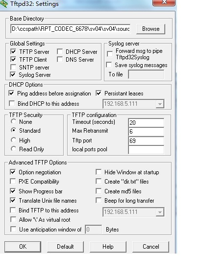

  • Hi,Hongmei:
    Thanks for your help.
    Now I can run sv04ccs on DSPC8681E.But tftp cannot start successfully.The error info is:
    Starting TFTP Get for bus_cif.yuv... Error receive from server!

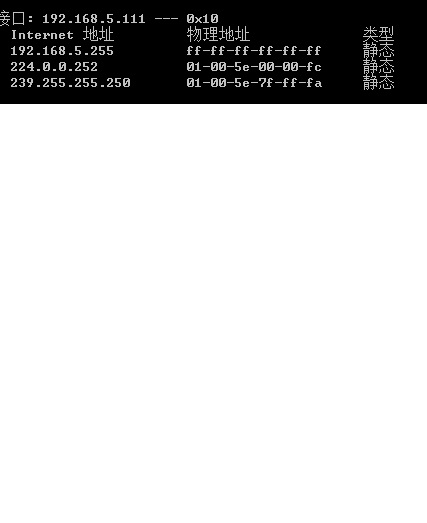

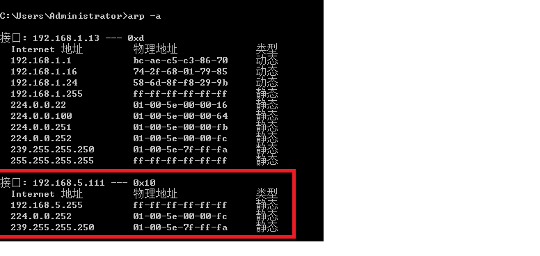

    My pc serveraddress is 192.168.5.111,My dsp localipaddress is 192.168.5.110.They are in the same SubNet.I connect pc and DSPC8681 with cable rather than through switch.
    When I run arp –a on server PC ,it shows in attached file:
    It means that PC as tftp server cannot receive the request RRQ from client DSP 192.168.5.110.I also snap the data packet using Wireshark in attached file.Hongmei I am not very skilled with network protocol ,Would you help me check the reason why server cannot receive the RRQ from DSP?
    7624.tftp.cfg
    http://e2e.ti.com/cfs-file.ashx/__key/communityserver-discussions-components-files/639/4643.Wiresharp-cap.7z

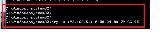

  • Hi David,
    According to the display of "arp -a" and your tftp.cfg, the arp entry for DSP is missing. Please follow instructions at http://processors.wiki.ti.com/index.php/MCSDK_VIDEO_2.0_CODEC_TEST_FW_User_Guide#4._Prepare_PC to enable ARP entry on the PC so that it can send packets to DSP. It would be as follows for your tftp.cfg
    arp -s 192.168.5.110 08-24-BA-79-CC-9E
    If your TFTP server is on a Windows PC, you may need to run the command window as administrator in order to do "arp -s".
    Hongmei

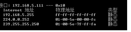

  • Hi,Hongmei:
    I follow your suggestion and run the command by administrator using arp -s.
    But error still appear.When I arp -a on PC ,dsp ip address still doesn't display  like below
    dsp ipaddress 192.168.5.110 is still not under list .

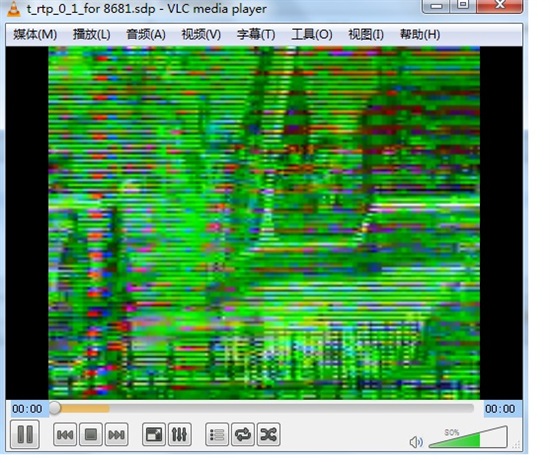

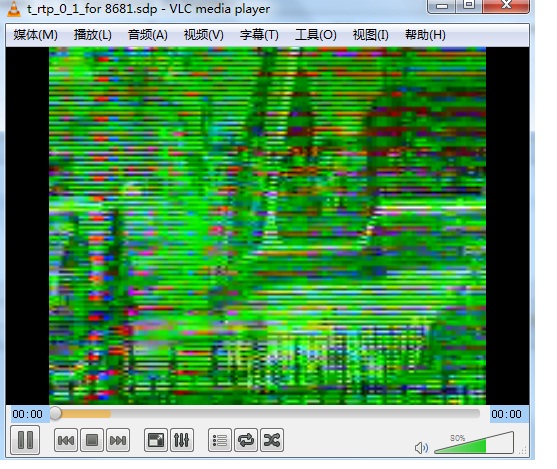

  • Hi,Hongmei&Paula:
    Now I have already transferred data from pc to 6678 via tftp .The arp issues have
    disappeared.thank you very much!
    And I also have encoded my cif yuv data successfully from the printf infos.But when
    bitstreams are send outside.VLC display mess.I don't know why.
    My input yuv data is cif 352x288.dsp ip is 192.168.5.110. port is 32770.
    The same time I modify the sdp file under the mcsdk folders you supply.
    Would you help me to check the sdp file I attached below? Thanks!
    http://e2e.ti.com/cfs-file.ashx/__key/communityserver-discussions-components-files/639/1106.t_5F00_rtp_5F00_0_5F00_1_5F00_for-8681.7z
  • Hi David,
    From the link "http://e2e.ti.com/support/dsp/c6000_multi-core_dsps/f/639/t/187260.aspx?pi267198=2":
    "VLC typically has problem receiving H264 RTP stream (without additional hinting via container mov/avi/ts etc). VLC can however decode other codecs properly. Please use mplayer to receive the stream."
    Please refer to the link above for more details.
    Hongmei
  • Hi,Hongmei:
    Thank you very much.Now I can play the sdp file in real-time and I can see the video playing
    fluently.Thanks again.
