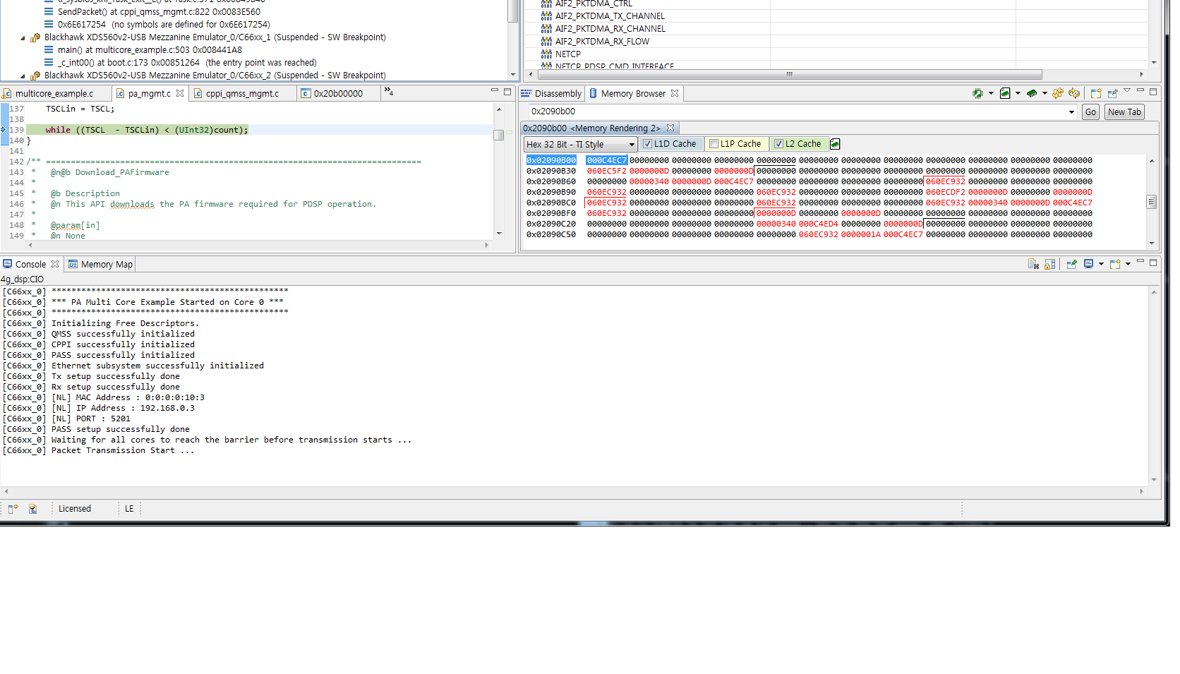

    Can you let us know (e.g, a screenshot) those registers in the first 10-20 seconds?
    Regards, Eric
    I check the register 0x2090b00, and i can see they are incremental. but tcpdump could not catch that packets.
    Below is a screenshot.

  • Thanks for additional test. 0x209_0b00 region shows the port statistics with Host. 0x2090c00 shows the port statistics with outside world. Specifically, 0x290_0c34 is the number of TX good frame from Gb switch, if you saw that incremental as well at the beginning, the packets should be sent to wire. Does the tcpdump on Linux OS work without loss the beginning packets if you replace TI card with another AMC ethernet card?
