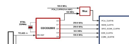

    What other difference in hardware do you have from the EVM? What is the OSCIN value have you confirmed the values of PLL multipliers and dividers on the device by running a GEL file with the same settings?
    Rahul
  • Rahul,
    When RBL boot from your bin file, the core is all messed up, such as clock is divided by 1000, loading file crashes the code.  I have to short FLASH chip to boot.  Then attached emulator to the target and run.  DDR location is not loaded.
    OSCIN = 100MHz, PLL settings are the same as GEL file's from CCSv5.

  • Hi Steve,
    Were you able to confirm with your hardware engineers that the reference clock on your custom board matches to the 100MHz CORE_CLK ? I am attaching a snapshot of the schematics for Gauss EVM.
    We suspect that your PLL settings may be overdriving the chip so we need to know the value of the reference clock on your board. As an experiment can you chnage the value at offset 0x08 in the boot image from 0x4020_0002 to 0000_0000 to not change the PLL, and change the device frequency set from offset 0x18 from 0x3e8 to 0x138 to have the boot ROM read the boot image at the same speed that it read the boot parameter table (which seems to be working).
    Rahul

  • Hi Rahul,
    We measured SYSCLKOUTs from EVM and our prototype board.  The output frequencies are the same.
    probe 1 is EVM and probe 2 is our board.
  • Hi Rahul,
    We have confirmed that our custom board has 100MHz clock matching EVM.  Also, our SYSCLKOUT matching EVM's too.  But both clock rates are about 266MHz, not 1GH/6 as we expected.  Do you know why?
    Thank you.
    Steve
