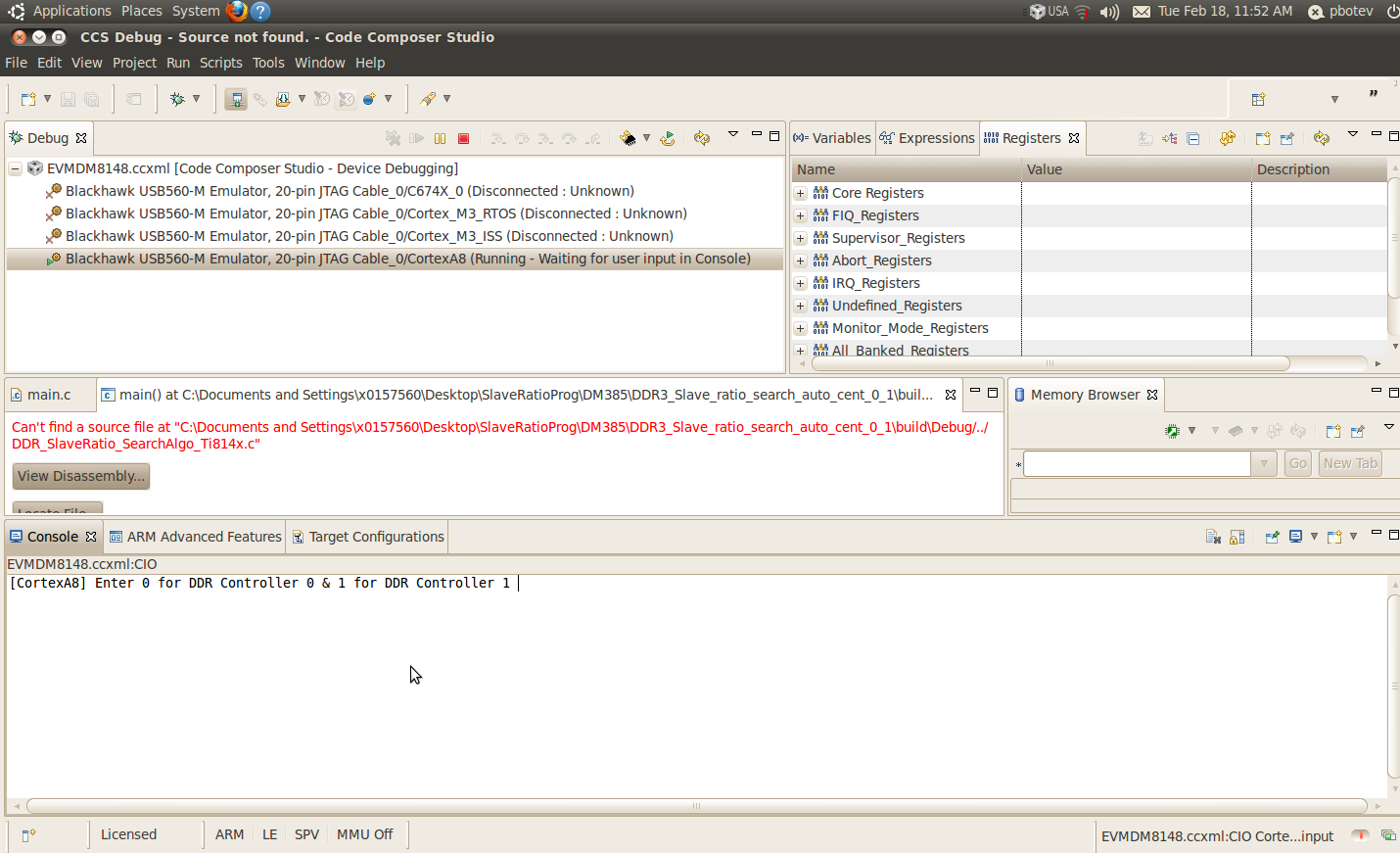

I'm running on a custom board with the DM8148 chip on it. The DM8148 is connected to 4 DDR3 memories on each of the EMIF interfaces. All the DDR3 memories are 128 MB; 8 -bit.
Following the procedure described in http://processors.wiki.ti.com/index.php?title=TI814x-DDR3-Init-U-Boot, I got no output after loading and running the DDR3_SlaveRatio_ByteWiseSearch_TI814x.out program.

After running the program the Cortex A8 ARM is in Running state, but nothing happens. When halting the Cortex A8, I could see that the PC is at 0x20080 and the memory from 0x20080 to 0x200bc is filled with the 0xEAFFFFFE value. Another thing that I noticed is that the status bar in the CCS5.3 shows the ABT indication (Abort Mode - Data or instruction prefetch abort occured).

    I just check this on my DM8148 EVM board, and it looks working fine. When I load the DDR3_SlaveRatio_ByteWiseSearch_TI814x.out file then click the "Run" button, the Cortex-A8 ARM is in running state, waiting for user input in console, see the screen shot:
    Please check again all your steps. Do you enable Neon and switch the ARM from user to supervisor mode?

    I just found the problem a few minutes ago:
    The procedure includes a part which describes the target configuration in CCS. Instead of using the EVMDM8148 configuration I used the DM8148 configuration. Hence, I was missing initializations such as the PLL of the ARM and the L3, the OCMC clock, etc.
    After taking the EVMDM8148 configuration, I was able to run the DDR3_SlaveRatio_ByteWiseSearch_TI814x.out program.
