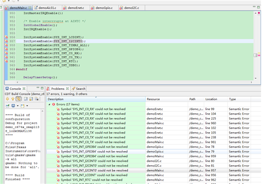

project demo_c674x_lcdkomapl138 in starterware has some bug when build and load!
Other Parts Discussed in Thread: OMAPL138
Hi, when I use the demo_c674x_omapl138_lcdkOMAPL138 on OMAPL138 LCDK,  I encount some  questions as the picture show.  I want to konw how to solve it , Thank you!
  • Hi Libin,
    I am able to import the demo project given at path "..\OMAPL138_StarterWare_1_10_03_03\build\c674x\cgt_ccs\omapl138\evmOMAPL138\demo" into CCS and build it succefully without any build issues.
    Here are the Steps.
    1. Open CCS
    2. click project, select "Import Existing CCS Eclipse project".
    3. In select-search directory, browse and locate the path "..\OMAPL138_StarterWare_1_10_03_03\build\c674x\cgt_ccs\omapl138\evmOMAPL138\demo"
    4. Click finish and build.
    Shankari
    Please click the Verify Answer button on this post if it answers your question.
  • Hi Shankari
          Thank you for your help, I found the problem was the version of ccs. When I changed to use ccs 5.0, it's ok.
    Now, I have anther question about how to record the sound from mic or line, for the in OMAPL138_StarterWare_1_10_03_03\build\c674x\cgt_ccs\omapl138\evmOMAPL138\demo  only have the funtion for playing the sound and I can't find any other demo for recording the sound.  Can you give me any advise about how to deal it ?  it's there any code file about it?  thank you very much!

  • HI Libin,
    One small correction in my previous post.
    1. If you are using the OMAPL138 LCDK board, take demo from path: "..\OMAPL138_StarterWare_1_10_03_03\build\c674x\cgt_ccs\omapl138\lcdkOMAPL138\demo"
    2. If you are using the OMAPL138 EVM, take demo from path:"..\OMAPL138_StarterWare_1_10_03_03\build\c674x\cgt_ccs\omapl138\evmOMAPL138\demo"
    To answer your question, the McASP play back in the demo example, will get the audio source from audio input in LINE IN and loop back (play) into the audio output on LINE OUT.
    In OMAPL138 LCDK, the "J10" has the LINEIN and LINE OUT(bottom) connector which shall be used for audio playback.
    To be more simpler, there is a separate McASP example available at path "..\ti\OMAPL138_StarterWare_1_10_03_03\build\c674x\cgt_ccs\omapl138\lcdkOMAPL138\mcasp"
    I don't think, any demo available for recording the audio from MIC. But you can take up this McASP sample project and configure the MIC as LINE IN and modify it for recording and playing.
    Please let me know how does it go and what do you learn.
