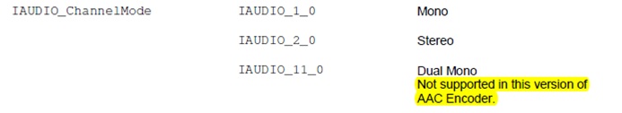

  • Thanks Ram,
    On the C674x the API doesn't support dual-mono configuration, only mono or stereo. If we use stereo for dual mono input, will your answer remains? will there be a quality degradation? can the encoder in this case encode one channels with more bits than the other?
    Just to verify, say I'm coding music on the left channel (mono) and noise on the right at 96kbps, will the music quality be the same as when coding 2 stereo music channels and listening only to the right channel?
    Amnon
  • Hi Amnon,
    AAC-Encoder on C674x doesn't support dual-mono. There is C64x+ version of AAC encoder and it supports dual-mono.
    Yes, for a dual-mono input, when encoded as stereo, no correlation between left and right channels will be exploited and it may degrade the quality.
