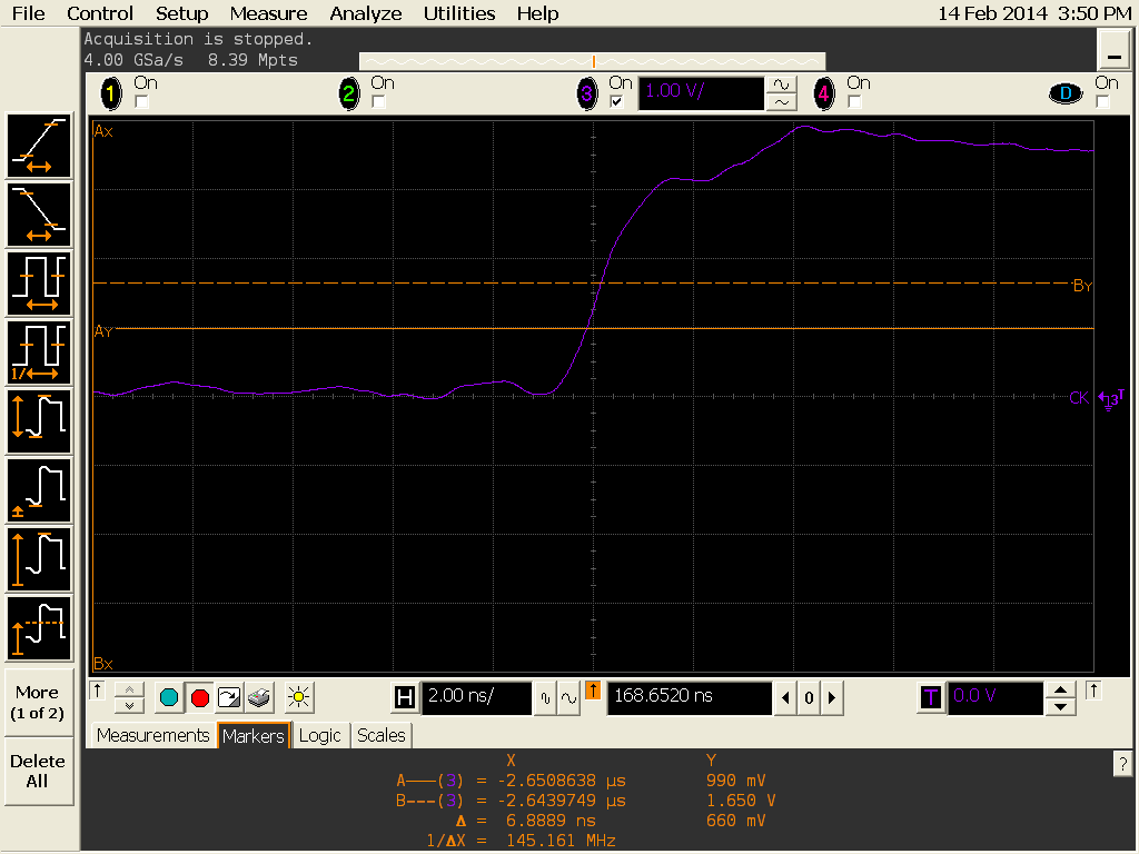

  • Hi Anthony!
    Thanks for your reply! Here are two plots (rising and falling edge) of the chip select signal connected to HDS1 & HCS, measured at the pin of HDS1.
    By modifying the CPLD, we can slightly increase the slew rate. However, even if we can increase the slew rate so that no error occurs during our tests, how can we be sure, that we are on the save side without a specifciation?

  • Hi Peter,
    Just to be sure: are the plot above the modified one that do not show the failure? or the original one when you get failure on the HPI transaction?
    We unfortunately do not specify the slew rate for the HPI signals. As already mentioned the information of the test signal we use might help to get an order of magnitude of what can be used.
    Anthony
  • Hi Anthony,
    the plots are from the original configuration, where we get the failure on the HPI transaction.
