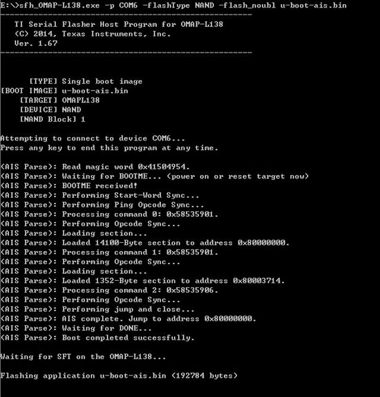

sfh_OMAP-L138.exe stop at: Flashing application u-boot-ais.bin (192784 bytes)
Other Parts Discussed in Thread: OMAP-L138, OMAPL138
I cann't write u-boot-ais.bin to my board.
The step is:
1 build u-boot
2 using AISgen_d800k008.exe and u-boot file to gernate BIN file:u-boot-ais.bin
3 flash to board, the command line is:
   sfh_OMAP-L138.exe -p COM6 -flashType NAND -flash_noubl u-boot-ais.bin
 stoped!!!
the log image is:
is it why?
who can help me to solved it?
Thanks very much!

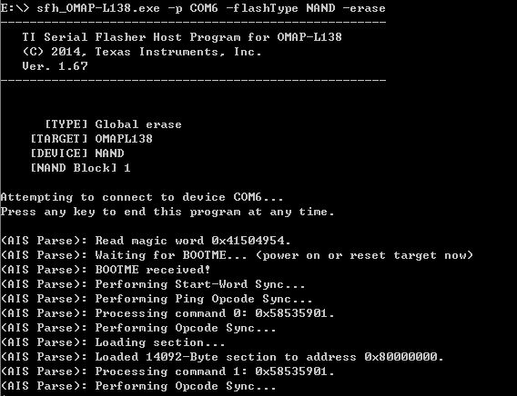

    3) Could you able to erase the NAND flash without any problems?
    Ex:
      sfh_OMAP-L138.exe -p COM6 -flashType NAND -erase
    ---->FAIL! STOP! the log is:
    What should I do?
    I really need your help! Thanks very much!
  • Hi Changsheng,
    Sorry, I could not see the errors properly from your screen shot.
    Whether it hangs at "Waiting for SFT" of some where else ?
    Can you please take full screen shot of that ?

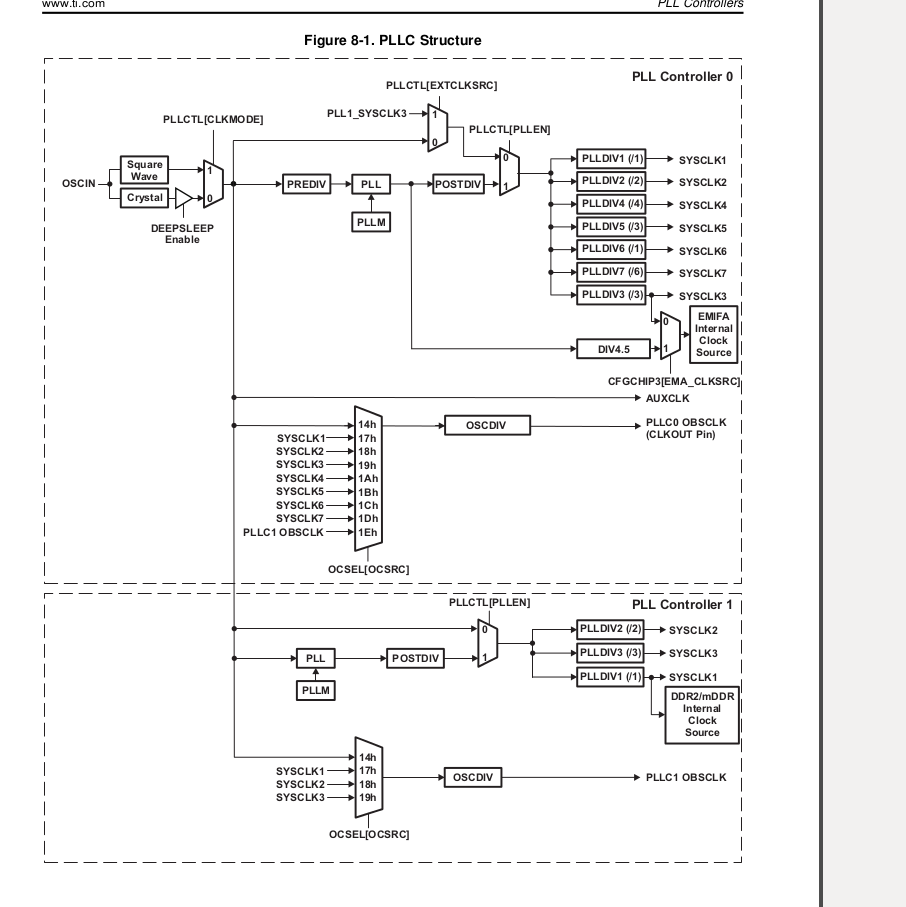

    PLL0 settings seems wrong,
    PLL0 (phase locked loop)  controller for ARM frequency.
    PLL1 controller for setting mDDR/DDR2 frequency.
    device_PLL0(unsigned int CLKMODE, unsigned int PLLM, unsigned int POSTDIV,unsigned int PLLDIV1, unsigned int PLLDIV2, unsigned int PLLDIV3, unsigned int PLLDIV7 )
    Ex for 456MHz :
        device_PLL0(0,18,0,0,1,18,5); //PLLM = 18, POSTDIV=0 {24MHz * (18+1) / (1+0) = 456}
    To achieve 360MHz:
        device_PLL0(0,14,0,0,1,18,5); //PLLM = 14, POSTDIV=0 {24MHz * (14+1) / (1+0) = 360}
    or
        device_PLL0(0,29,1,0,1,18,5); //PLLM = 29, POSTDIV=1 {24MHz * (29+1) / (1+1) = 360}
    Otherwise use default gel file 300MHz settings for test case at ti/ccsv5/ccs_base/emulation/boards/evmomapl138/gel/EVMOMAPL138_ARM.gel
    After changing those settings , Probe the ARM o/p frequency through CRO and Please let me know the results.
