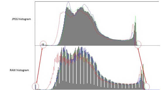

Hi, all!
       My version: DM8168, DVRRDK_04.00.00.03
       I get yuv420sp from nfs  and jpeg from encode, the I convert yuv420sp to bmp using my C code. I find that Jpeg qaulity is lower than bmp.  Then I view the code mcfw/src_bios6/links_m3video/iva_enc/encLink_jpeg.c, I changed value of qp, but it didn't work.
      My question: How can I get a high quality jpeg, which parameter can do it ?
 Thanks a lot.
  • The JPEG encoder version used in DVRRDK is old. You can migrate to REL.500.V.MJPEG.E.IVAHD.01.00.14.00 encoder release which supports setting of targetBitrate, quality factor and selection of rate control algorithm.
    You can get the latest encoder package from TI FAE.
    It requires some changes in encLink to integrate new JPEG encoder. Once you have the encoder release we wiil share patch with required encLink changes.

    My problem is, when I compare the histogram of my RAW capture and of my jpeg picture, I see a differnce.
    The histogram of the RAW picture show that the entire range of 0 to 255 is used but on the histogram of the jpeg, it is between 16 and 245 (see attached file).
    This gives the impression that the JPEG image is blur.
    I searched around the DVRRDK and I don't find how to tell the compressor to encode JPEG image on a range of values ​​from 0 to 255.
    Can you help me ?
    regards
  • Can you pls migrate to latest MJPEG encoder REL.500.V.MJPEG.E.IVAHD.01.00.14.00 and apply the patch in this thread and set the targetBitrate .The MJPEG encoder version you are currently using doesn't support setting bitrate/quality level.You can get the latest encoder from TI FAE.
  • Hi Badri,
    Ok I will contact my TI FAE to obtain new MJPEG encoder.
    But, do you think this will fix my problem?
    In terms of quality of image details, the result is correct (qpInit = 97), but it is really the problem of non-use of the range of 0 to 255 which gives the impression of a bad return.
    What do you think about that?
    regards
  • I dont think it will resolve the pixel range issue but there is known quality issue due to lack of support for targteBitrate and rcAlgo in the encoder version you are using.I will check with encoder team on the pixel range issue but only latest encoder version is actively supported so migration to latest version will enable codec team provide bug fixes if any
