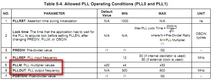

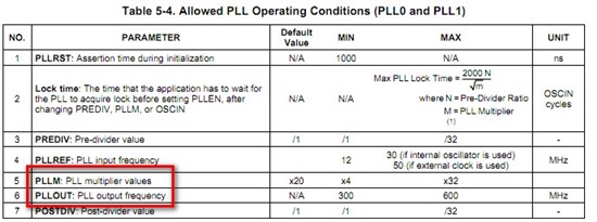

is the dsp maximal frequence 372 MHz actually???
I want to configure the core wroing at 375MHz .HOW can i do it ???
There are two independent factors here:
