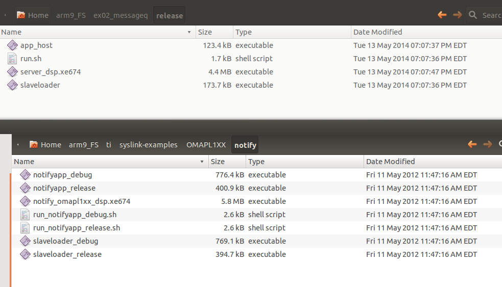

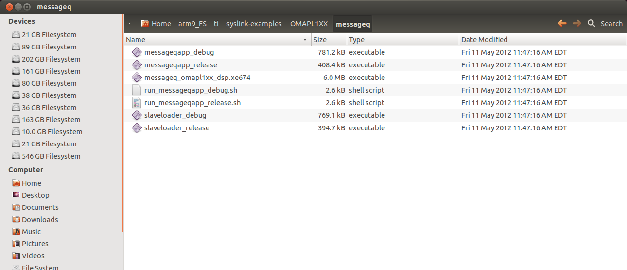

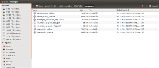

    I have the same error as the original post. I do not find a solution after I check the link above. I would like to get a confirmation whether MessageQ and other example projects can be successfully run without errors.
    I find that L138 LCDK has 128 MB DRAM. After reading below on line:
    Configuring Kernel Parameters
    SysLink requires a few specific arguments to be passed to the Linux kernel during boot up. To run the examples, 3MB of memory is needed by SysLink for communication between GPP and slave(s), and for slave(s) external memory usage to place its code/data sections. This must be reserved by specifying 3MB less of available memory for Linux kernel usage.
    • For example, with available memory of 256M, memory required for shared regions/other utils is 5M and SysLink is 3M leaving only 248M for the Linux kernel.
    bootargs console=ttyS2,115200n8 root=/dev/nfs nfsroot=HOST:nfs_root,nolock rw mem=248M ip=dhcp
    I set the boot args as:
    setenv bootargs console=ttyS2,115200n8 rw noinitrd root=/dev/nfs nfsroot=192.168.0.103:/home/lcdkl138/arm9_FS,nolock rw mem=110M ip=dhcp earlyprintk rootdelay=2,rsize=1024,wsize=1024 ip=dhcp
    Is it right? I would like to make sure the memory setting is correct first.
  • Another thing seems strange to me. The following link gives the example execute projects path: (/ti/syslink-examples/<device>)
    http://processors.wiki.ti.com/index.php/SysLink_Install_Guide#Installing_Examples
    Running Examples
    Each example contains a readme.txt and run.sh script to demonstrate how to run it.
    The root of the samples directory on the target file-system (/ti/syslink-examples/<device>) contains a script to execute all the examples provided.
    On my host PC, I find that the dates of these execute files are old (2012). I do not find the products.mak including such path. What generates such folder and files? The old dates are right?
  • I remember that OMAP L138 evm and L138 LCDK have different memory or something else. But I do not see the syslink examples build differentiate those two. Anyone knows I should care about these two or not? Thanks,

    I also notice that the executables of messageq (both debug and release versions, especially DSP core code size) have different size with the SD card partition 3 fiiles (of course their names are different)
    Here is a picture of the release file size:
    It is about 123.4 kB vs. 400.9 kB. DSP core size is 4.4 MB vs. 5.8 MB. What makes such a difference?
