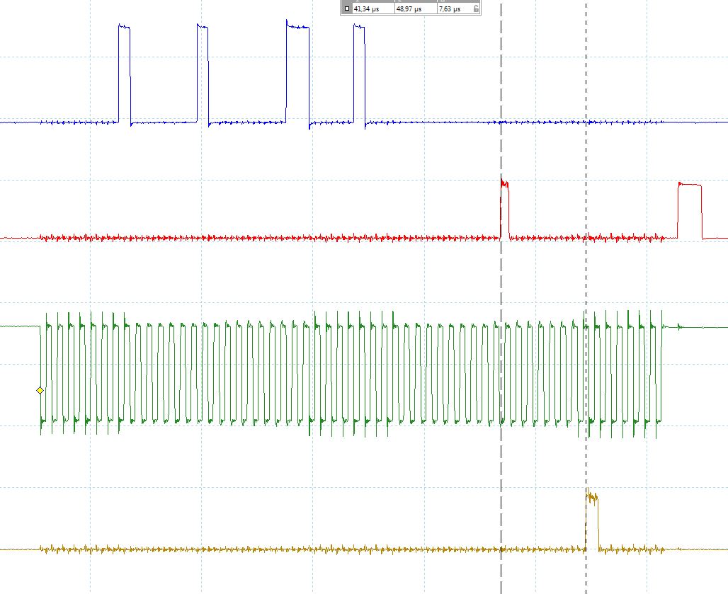

I've spent some time with an irritating problem - not a showstopper, I can live with it - but irritating!!! Main question is that how to finalize SPI/EDMA transfer frame in a controlled way. EDMA-finishing interrupt server is the main problem
Below is the interrupt server code and below that scope view where blu-SIMO, grn-CLK, red-EdmaIsr and yel-Edma3CCErrHandlerIsr. TX- int is not interesting to me because RX is not completed yet that time- so I would only need RX-int (EDMA3_CHA_SPI0_RX) . I've tried to get rid of the TX-int (EDMA3_CHA_SPI0_TX) but not managed, I need to acknowledge it somehow, below is the minimum I've found. . I've tried to get rid of the Edma3CCErrHandlerIsr after every TX-int but not managed.
I can let the Edma3CCErrHandlerIsr to shoot these extra interrupts but they are waste of resources and I would like to know if this problem will one day stop the SPI-EDMA totally.
No-one but these IR- servers is touching SPI in the mean time, the length of the data does not change anything. All flags have been deactivated before lounching the xfer, if not properly would cause this problem earlier than the last byte??

blu-SIMO,
grn-CLK,
red-EdmaIsr and
  • Risto,
    It will make the job easier for your readers if you list your signals in the same order as they are shown. The colors make that arbitrary, but quick conceptualization is easier with obvious ordering.
    Try slowing down your SPI clock to see if the problem is related to relative speeds.
    It is not clear what you are trying to do in the EDMA ISR with your Rx code. You clear the SPI interrupt instead of the EDMA IPR interrupt bit.
    You should not be getting any EDMA3CC error interrupts. This needs to be pursued to get rid of those. The speed test will be very useful.
    Also, please show your DMA channel PARAM initialization code.

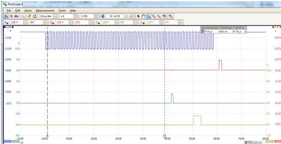

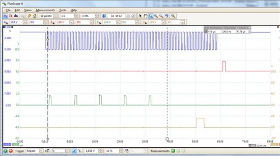

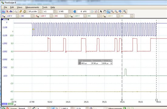

    I did some additional tests with SPI-EDMA. I dropped SPI-CLK to ~800kHz. Below is a scope screen, where
    BLUE: SPI-CLK
    RED: RX-INT
    GREEN: TX-INT
    YELLOW: EDMA-ERR-INT
    UPPER figure:Transfer complete interrupt enable.
    LOWER figure: Intermediate transfer completion interrupt enable.
    In both figures  TX-bCnt=RX-bCnt=7
    When transmission of 7th byte starts, an ERR will occur caused by "Null PaRAM set" leading to a missed event - I believe (as in http://e2e.ti.com/support/dsp/omap_applications_processors/f/42/t/221143.aspx)
    Why does it come after 6th, one byte is missing? If TX-bCnt=7 and RX-bCnt=5 the error will not occur but data will be nonsense as CS- timing will not match. With self-link ERR could be removed, but I think TX data would not  then be right: the 7th byte out would actually be 1st??
    risto
    I linked dummy PaRAM set to TX-PaRAM set and it seems to work, data 1,2,3,4,5,6,7 goes right and EDMA-ERR does not occur, so from my side asction is closed if you don't want to comment?
