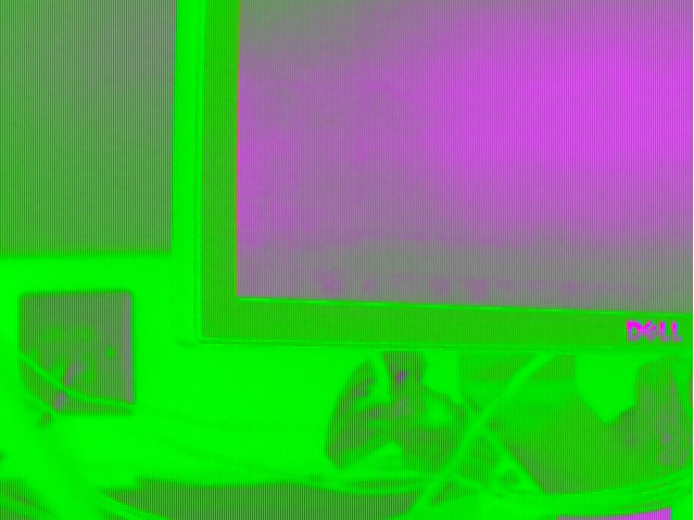

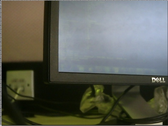

I am attaching the screen shots of both YUV 422 and YUV 420 images.
YUV422:
YUV420:
Can anyone please tell what is the problem? Why is YUV 420 image coming like this? Is the resizer configuration proper?

    After checking, I found that the resizer expects YUV422 to be in UYVY format whereas I was passing YUV422YUYV to the resizer. Please see the link below
    http://e2e.ti.com/support/embedded/linux/f/354/t/63988.aspx
    When I viewed YUV422yuyv image in YUV422uyvy format using the YUV viewer, it is same as YUV420 image which I am getting after the conversion.
    So it means, resizer is taking YUV422yuyv image in YUV422uyvy format as input and converting it into YUV420. Thus, there is no problem with the resizer.The problem is with the input format YUV422yuyv.
    Please correct me if my understanding is wrong.
    YUV422 viewed in YUV422YUYV format
     YUV422 viewed in YUV422UYVY format
    YUV420 after conversion
    So now since the sensor gives the image in YUV422YUYV and not in YUV422UYVY format, I can neither pass this image directly to resizer nor to the encoder, how do I proceed now?
    How can I encode YUV422yuyv image? Is there any way by which I can convert YUV422YUYV into YUV422uyvy format?

    I configured the sensor to output in uyvy instead of yuyv. With this format, resizer works and gives YUV 420 which i am passing to the encoder and getting JPEG image.
