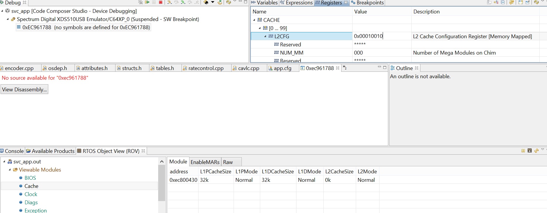

1) I Wanted to enable part of L2 as Cache. I did this thru' the GEL file(attached) and confirmed thru console messages.
Now when I check ROV and Register view , I get different results. Attached the snap shots.
ROV says that L2 Cache size 0k when the register value  says that 64K (L2CFG=0x00010010)
But the GEL file is L2  settings are 3/4 SRAM . I am confused.  Which one is correct?
I see no improvement in performance when Cache= 0  to 3/4 SRAM.

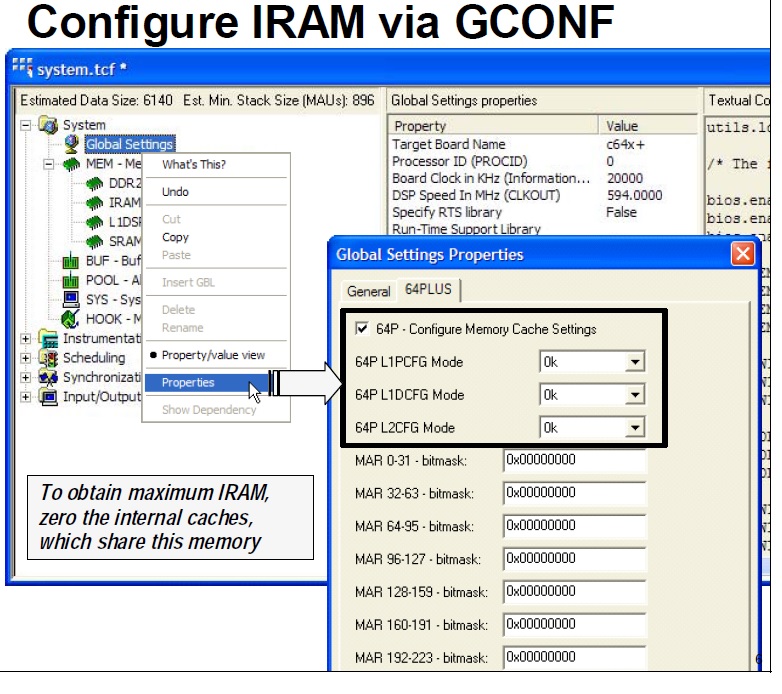

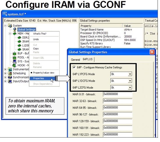

3) Can I configure, enable/disable the  Cache thru' SYS/BIOS XGCONF?  I saw previous version CCS supports configuring Cache thru GCONF like below
How can I configure cache using XGCONF in CCS 5.5?
