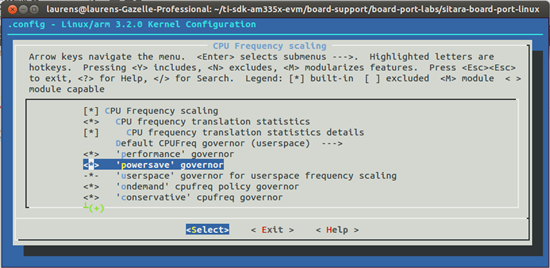

    I tried the above link : processors.wiki.ti.com/index.php/AM335x_Power_Management_User_guide
    But as you can see here;
    All the options are included by default, I use the am335x_evm_defconfig. And yes i'm trying to read the cpu freq in userspace. I do have a /proc directory but nothing that can give me the cpufreq.
