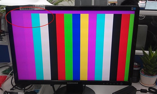

Hi, I use RDK4.0.0.3 on DM8168. Our application is DM8168 capture a signle 1080P@60 video from FPGA. Data format is Y/C 16 bit discrete sync. i refrence multichhd_vcap_venc_vdis.c usecase. So I modify the capture link as follow:

    The changes are correct assuming you input is 16bit discrete sync with hsync/vsync style of capture.

    But the preview display has some errors.  Our usecase file is:

  • Hi Colin,
    Since you are using hsync/vsync style of capture, there will be some vertical blanking region that will be captured in memory. You will have to crop this region either using VIP trimmer or in memory.

  • Hi Colin,
    In hsync/vsync style of capture, vip port capture vertical and horizontal blanking area also. This size of this blanking area depends on the input resolution. There is trimmer in the vip module, using this trimmer you could trim out the blanking area and get the correct output. To enable trimming, call ioctl IOCTL_VPS_CAPT_SET_VIP_CROP_CFG with the Vps_CaptVipCropParams structure as argument. You will need to set the position and size of the cropping window. Here the position is your size of the blanking area.

  • Brijesh,
    vipCropPrms Params is:
      vipCropPrms.channelNum = 0u;
      vipCropPrms.vipCropCfg.cropStartX = 192;
      vipCropPrms.vipCropCfg.cropStartY = 41;
      vipCropPrms.vipCropCfg.cropWidth = 1920;
      vipCropPrms.vipCropCfg.cropHeight =1080;
    But there is no any display.

  • Hi Colin,
    Can you please share the capture statistics? You could get the statistics by pressing 'i' while dvr-rdk is running. This will tell us exactly what frame size is getting captured. If it is not 1080p resolution, you still have to make sure it is correct by changing crop window.

  • Brijesh,
    I use RDK 4.0 version, DM8168 is ES2.0.  But I think DM8168 start to capture video data by detect hs sync falling edge, not by active sync. So DM8168 also capture hs blank data. Why DM8168 not detect active sync?
  • Hi Colin,
    There is an driver interface to change hsync/vsync/de and clock polarity. Please use this and see if it fix the issue.
