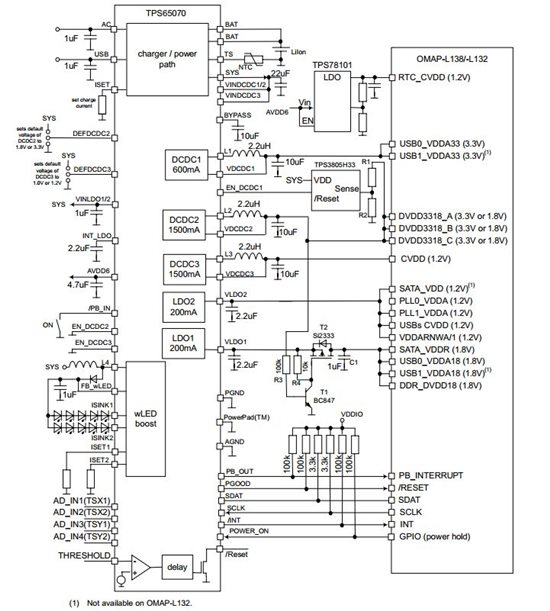

C6748 power-up sequence as defined in datasheet (section 5.3.1) states that power-up sequence should be:
RTC_CVDD --> Core 1.2V --> static 1.2V --> all static 1.8V -->  All 3.3V.
Now, Application report for TPS65070 (SLVA371B) shows that the sequence is dependent on LVCMOS operating voltage.
For DVDD3318ABC @1.8V:  RTC_CVDD --> Core 1.2V --> static 1.2V --> DVDD@1.8V --> all static 1.8V -->  All 3.3V.
For DVDD3318ABC @3.3V:  RTC_CVDD --> Core 1.2V --> static 1.2V --> all static 1.8V -->  DVDD@3.3V --> All 3.3V
The datasheet does not mandate DVDD3318 supplies to be powered before static rails, neither does the ref. manual. Is this an oversight in the datasheet?
The problem I have is that I can't use TPS65070 because it does not offer external sync clock option. My application requires all PSUs to be locked to a master clock source.

  • Hi Antony,
    Thanks for your reply.
    In such case can you please explain the reason for the added delay between static 1.8V and DVDD3318 running at 1.8V (T2 in attached picture)?
    J
  • Hi John,
    The application note says the output of the LDO1 to the OMAP-L138/C6748 delayed by an external circuit consisting of T1, T2, R3 and R4 to meet the correct power-up sequence requirements.
    Bu the in the power requirement Table 1 they didn’t mentioned anything about Time delay.
    So, with respect to datasheet, if 1.8-V LVCMOS is used, power rails up with the 1.8-V rails. If 3.3-V LVCMOS is used, power it up with the ANALOG33 rails (VDDA33_USB0/1).Absolutely there is no need of time delay in between them.
    Basically we need the 1.2V ramped up to nominal level before you start ramping up the 1.8V then followed by 3.3V any realistic delay should be ok, but I don’t see any requirement for delay in between static 1.8V and LVCMOS 1.8V supply.
