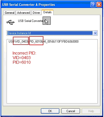

1) Checked my PCs “Device Manager”. Device detected as
2) While working, J2 USB port disconnected by itself (approximately 3 minutes from J2 connected)
   When I tried to click “Target-ConnectTarget”, following error message displayed
3) Next, updated PID as “A6D0” with the help of “Mprog3.5”
   Reference :
       1) http://processors.wiki.ti.com/index.php/XDS100#Troubleshooting
       2) http://www.ftdichip.com/Support/Utilities.html
4) Program succeeded. Did “Cycle Device”
   Checked my PCs “Device Manager”. Device detected correctly as
5) Again, issue at “step 2” re-appeared. (J2 disconnected by itself)

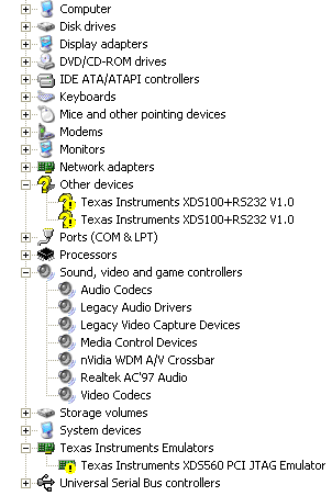

7) From this time, device is detected in
     Other devices
     Texas Instruments XDS100+RS232 V1.0
     And target is not getting connected with CCS or with Mprog.
Tried to scan device with Mprog, but gives result as,
Number of Blank Devices = 0
Number of Programmed Devices = 0
Also, tried to Erase Device with Mprog, but gives result as,
No Devices found ...
Now, how to recover ?
Please provide recovery method to get the device working.
