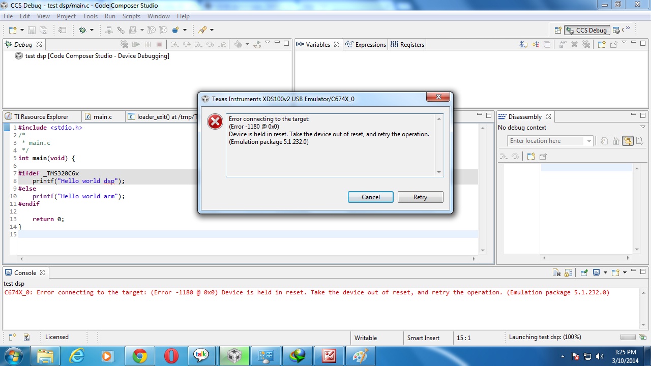

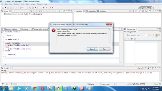

Hi Vivek,

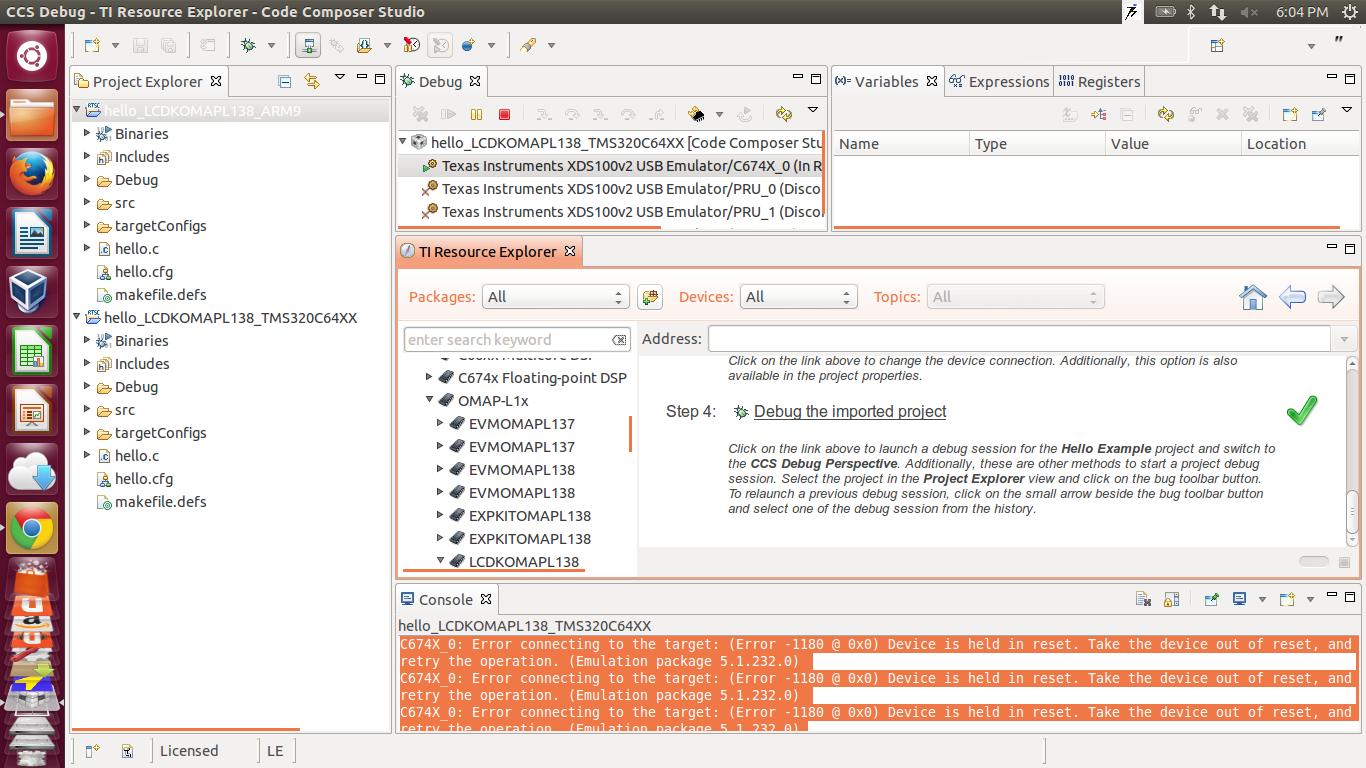

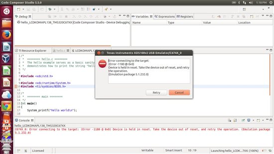

I assume that the DSP is in reset state (it should wakeup through ARM) and you are trying to run the DSP app in it.
I)

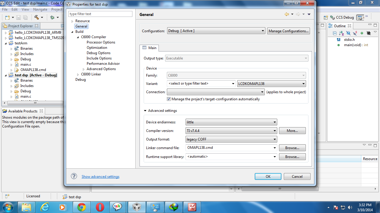

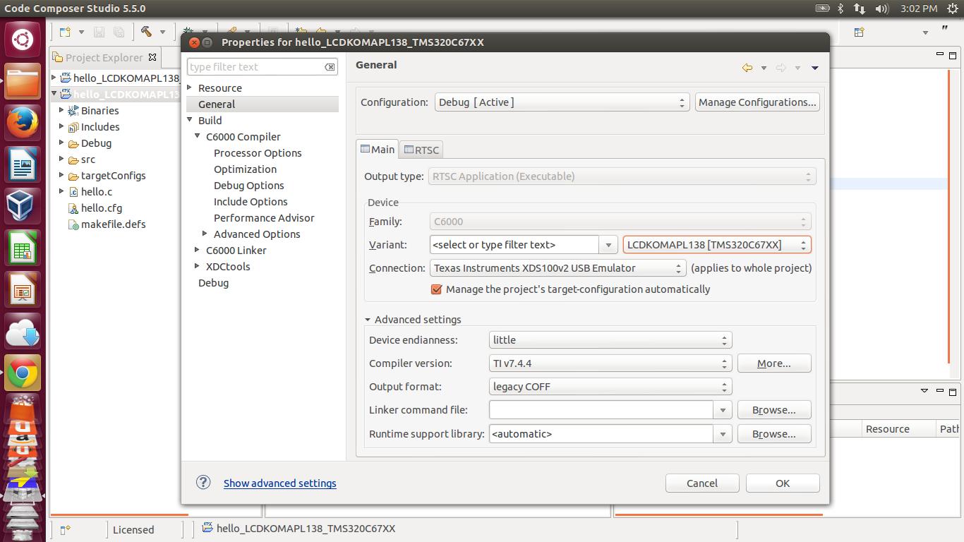

Step 1) Open a new example hello world project and select family as "C6000" and not ARM.
Step 2) Select the DSP hello world project and select "Debug as" option for debugging DSP code through emulator.
Refer the following ink for attachments (screen shots)
http://e2e.ti.com/support/dsp/tms320c6000_high_performance_dsps/f/115/t/323699.aspx
II)
After you ran the ARM, Click right option of DSP core and select "Target connect option"
Please select appropriate gel file for each core(ARM/DSP) through init script option.
Refer the following old e2e post.
http://e2e.ti.com/support/dsp/omap_applications_processors/f/42/t/325985.aspx
