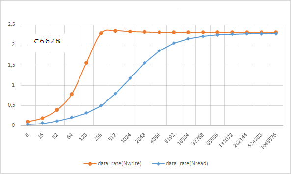

I'm testing SRIO on C6678, the plateforme i'm using is an 80HSPSPS1616, the two Dsp connect to each other by SRIO using a switch CPS1616 .
I use maintenance transaction to configure the switch registers and then i started doing several different number of transfers and different transfer size to study the variations between the several choices .
to test the performance: i use one as master and the other as slave , i configure both of them as 1x with a 3.125Gbps s link rate. To transfer data i use Nwrite, Swrite ,Nwrite_R and Read and i have verified that the data has correctly transfered.

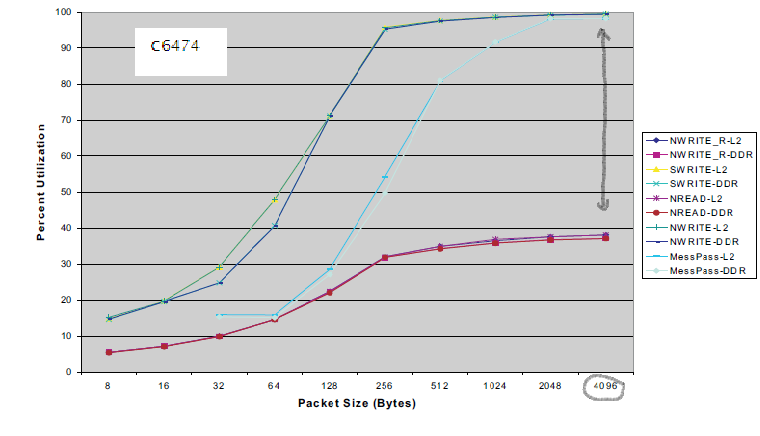

My question is about the result i got : From what i read (Read & Nwrite_R) should be slower than (Swrite & Nwrite) but from the result i got and from a certain value (8192 Bytes) they had the same rate(2.3 Gbps) which is close to the theoretrical value calculated for (swrite & nwrite ) ??
Is there any way to calculate the theoretrical value for (Read & NWrite_R transactions )?
And why they got the same rate from a certain value ??
thank you ,waitting for your answer!
