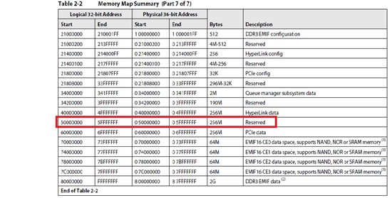

I use C6678DSP.  I set MSMCSRAM to non-cacheable by using MPAX register to map 0x0C000000 to a virtual
address 0x50000000.
After MSMCSRAM address map , i find i cannot  data copy from L2 to  the mapped address(0x50000000) by EDMA.
 what shoule i do?
 Is  EDMA supported data copy from L2 to  mapped address?

    Here, some conflict with the address which is used by you. See the memory map.

  • Hi Su,
    There are two sets of MPAX registers, one in DSP and one in MSMC.  To enable EDMA accessing the mapped memory, you need to configure the MPAX registers in MSMC.
