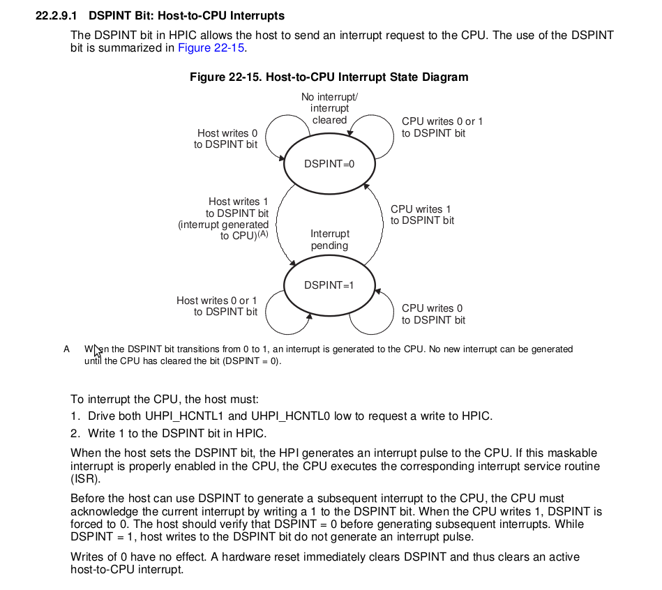

Bing
    To interrupt the CPU, the host must:
    1. Drive both UHPI_HCNTL1 and UHPI_HCNTL0 low to request a write to HPIC.
    2. Write 1 to the DSPINT bit in HPIC.
    When the host sets the DSPINT bit, the HPI generates an interrupt pulse to the CPU. If this maskable
    interrupt is properly enabled in the CPU, the CPU executes the corresponding interrupt service routine
    (ISR).
    Before the host can use DSPINT to generate a subsequent interrupt to the CPU, the CPU must
    acknowledge the current interrupt by writing a 1 to the DSPINT bit. When the CPU writes 1, DSPINT is
    forced to 0. The host should verify that DSPINT = 0 before generating subsequent interrupts. While
    DSPINT = 1, host writes to the DSPINT bit do not generate an interrupt pulse.
    Writes of 0 have no effect. A hardware reset immediately clears DSPINT and thus clears an active
    host-to-CPU interrupt.
  • Hello Stalin,
    Thanks for your reply. But I think this is not my problem. I can use MSP430 to interrupt DSP successfully and I can read the value of HPIC in the debug window of CCS for DSP. My problem is after I write HPIA and HPID, the DSP cannot update the value of memory according to HPIA and HPID.

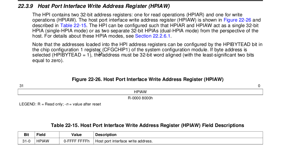

  • Hi Bing,
    Note that the addresses loaded into the HPI address registers can be configured by the HPIBYTEAD bit in
    the chip configuration 1 register (CFGCHIP1) of the system configuration module. If byte address is
    selected (HPIBYTEAD = 1), the address must be 32-bit word aligned (with the least-significant two bits
    equal to zero).
    According to the TRM, Have you configured CFGCHIP register for HPIBYTEID?
