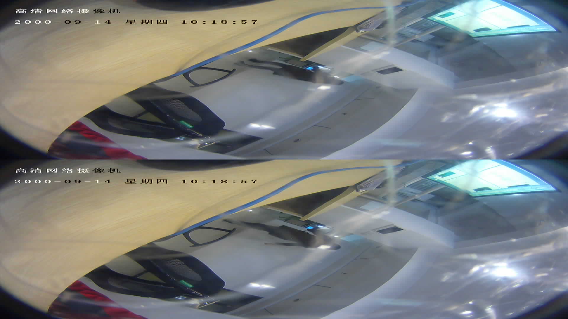

Dear all,
I am working on dm8168, with the DVRRDK4.1.
I encode mjpeg ,when resolutin of 1920*1080,image normal,that resolution of 2048*1536,image with tripe.
how encode 2048*1536 for mjpeg?
  • What is the issue you are seeing ? Attach the encoded JPEG image.What is your data flow (DVRRDK link connections) ? HDVPSS modules don't support processing of 2048x1536 frames.
  • My data flow is YUV422. I will data send to encoder ,then get encoded data save as jpeg file.
    When YUV422 is resolution of 2048*1536,Jpeg image of encoder is wrong ,
  • Can DM8168 encoding 2048 * 1536 resolution'YUV data?
  • Do you mean your data flow is:
    ipcFramesOutHLOS (A8) -> ipcFramesIn (Video m3) -> encLink -> ipcBitsOutRTOS (VideoM3) -> ipcBitsInHost (A8) ?
    The JPEG files shows image is encoded as 1920x1080 YUV420SP. Check the encoder configuration by printing the codec static and dynamic params in encLink_mjpeg.c
  • yes.
    I have find in encLink_jpeg.c, but don't know how to set the encoding resolution.
    You can help me with it ?
  • It gets resolution info from previous link. Attach your usecase file and the app logs.
