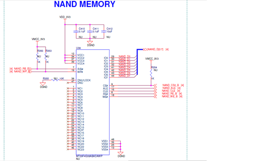

In our customized design with AM3352, we want to boot from nand. We used u-boot and kernel from sitara am335x sdk as a reference. Currently we are using mmc0 for booting.  When I build u-boot source, there are two images for first stage u-boot are created in bellow u-boot path,

    And as i mention in last post, It's also not boot when flashing NAND using mmc0.
    After flashing NAND, I kept the sysboot config 10010b since it has NAND as first boot mode. Bellow messages appears on console upon reset,
    "CCCCCCCCCCCCCCCCCCCCCCCCCCCCCCCCCCCCCCCCCCCCCC"
    Shabbir Limdiwala
  • The CCCCCC characters mean that the ROM bootloader is trying to boot from UART. It has most probably tried to boot from the other devices of your SYSBOOT configuration, but failed.
    This looks like either a hardware issue, or a NAND part that is not supported for boot.
    You can take a look at the AM335x TRM, section 26.1.7.4 NAND, Table 26-14. Supported NAND Devices for supported NAND devices.

    1. sysboot[15:0] = 0x4012
    2. Part no. MT29F4G08ABADAWP and attaching the datasheet 0820.nand_datasheet.pdf
    3. Here is the nand connections,
    Shabbir Limdiwala

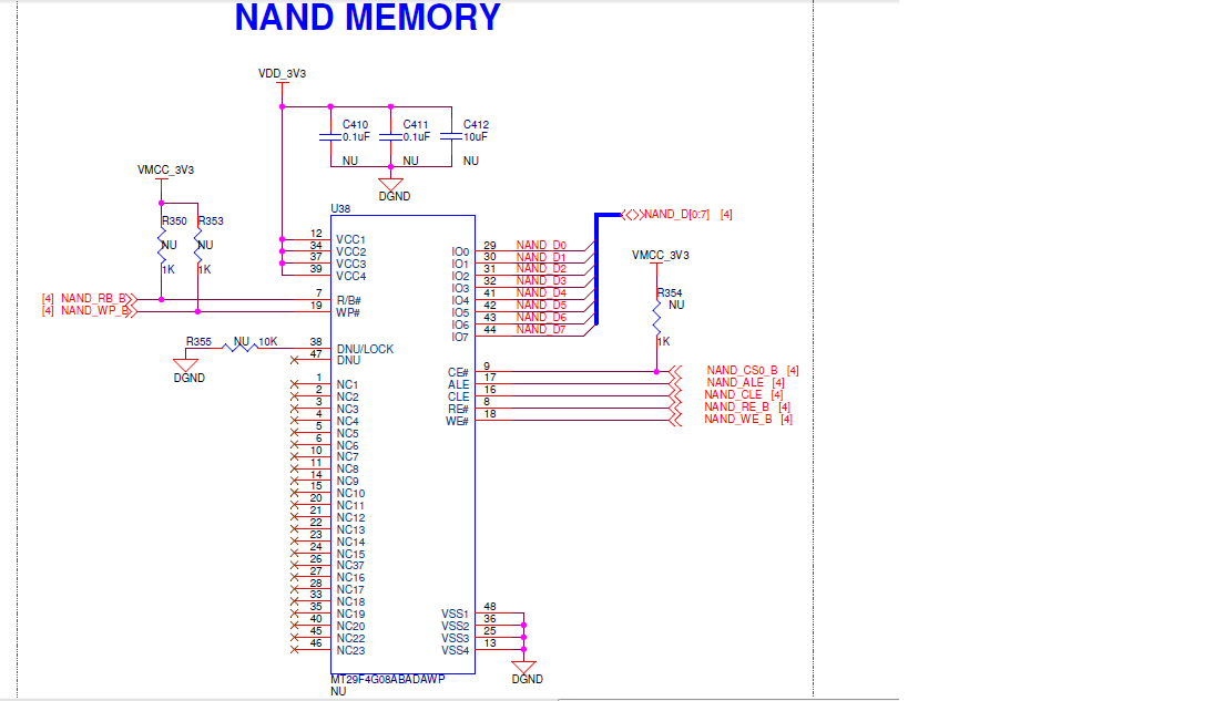

    3. Attaching the connection diagram,
    Shabbir Limdiwala
  • Hi Shabbir,
    1. SYSBOOT is OK.
    2. NAND part is ONFI compliant, should be supported by AM335X ROM code.
    3. Where is NAND_RB_B connected? It must be connected to GPMC_WAIT0 (AM335X pin T17 on ZCZ package). An external 4.7k pullup resistor must be present.
  • Hi Biser,
    Yes NAND_RB_B is connected to GPMC_WAIT0. I removed 1K pullup and mount 4.7K pullup but still didn't get success.
    Do you think this NAND is not supported by AM3352 ROM code ? According to the TRM of AM335x and datasheet of the NAND, This nand is ONFI compliant and supported by AM335x.

  • Hi Biser,
    One more important thing i want to inform you, Ethernet PHY is connected to port 2 of the ethernet mac and switch (cpsw). According to the silicon errata this may create problem when booting from NAND as GPMC_WAIT0 signal is multiplexed with GMII2_CRS.
    So, just to make sure nand boot is working, I have disabled all the configuration of PHY and flash nand from u-boot. Still it is not working.
    I am surprised with behavior, any idea still what causing the problem ?
    Shabbir Limdiwala
  • This is very important indeed. What you should do is physically disconnect the  GMII2_CRS line from WAIT0. Disabling in U-boot makes no sense as you cannot reach this stage when you try to boot from NAND.
  • Hi Biser,
    Good news. It can able to boot from NAND. I have physically disconnected GMII2_CRS line from GPMC_WAIT0 and it's working.
    Thanks Biser and Miroslav for your continuous support. Really appreciable.

    I am also facing the same issue. while UART/SD my nand is booting. By default my NAND is not booting.
    Always GPMC_WAIT0 is showing as high using CRO. I am using Ethernet and using Port1.
    I am using 8 bit NAND, SDK6. How can i resolve my issue.
