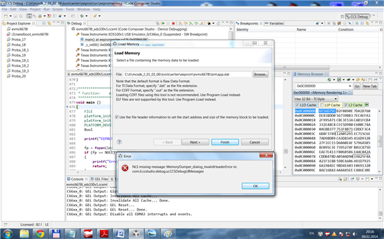

After this item I have got the the error message:
"NLS missing message:MemoryDumping_dialog_invalidHeaderError in:
com.ti.ccstidio.debug.ui.CCSDebugUIMessages"
I used:
Code Composer Studio
Version: 5.2.1.00018
mcsdk_2_01_02_06
TMDXEVM6678L EVM Hardware
Please explain me what I did incorrectly?
  • Mistake has been found already:  using   app.dat   instead of  app.bin
    Thanks for all.
