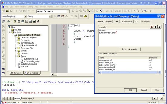

    If you are using DSP/BIOS, you can not alter the CMD file auto-generated by DSP/BIOS. You should add a custom cmd file with the groups you want. For example:
    SECTIONS
     GROUP >  SDRAM
        .text:_createStreams .text:_prime
        .text
    Add this file to your project (so the project will have 2 cmd files). Add the -mo option. Also, in your linker order option put the custom linker file before the file generated by BIOS:
  • Thank You Marianna and Randy,
    I did used a separate CMD file, like You suggested. The mistake was, as Randy mentioned, in dot in front of GROUP keyword.
    The mistake is in examples shown documents SPRUG82A (TMS320C674x DSP Cache User's Guide) pages 56-57, and SPRU862B (TMS320C64x+ DSP Cache User's Guide) pages 58-59.
    Thank You both!
