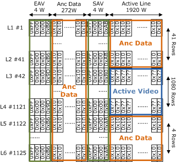

   I am now using EVM8168 + Custom FPGA board.  I managed to verify my dummy 1080p30 BT.1120 frame.  The pins are connected like this:
    FPGA Y_Out[7:0]        ===>  VIN Port[15:8]
    FPGA CbCr_Out[7:0]  ===>  VIN Port[7:0]
    74.25MHz Clk              ===> VIN0_CLKA
    I modified my 1080p60 Capture + Disp usecase to an 1080p30 one.  And my FPGA would continuously generate 1080p30 BT.1120 video frame once powered.  I tried to run the 1080p30 Capture + Display usecase.  However, the monitor display nothing as if there were no video signal on the VIN0 Port.  Although I have my verilog HDL verified by using Modelsim,  I eager to know whether the DM8168 provides some usecase or some relevant register which concerned about the capture link.
    Could you please give me some tips?  How can I confirm the DM8168 has successfully detected my video frame?

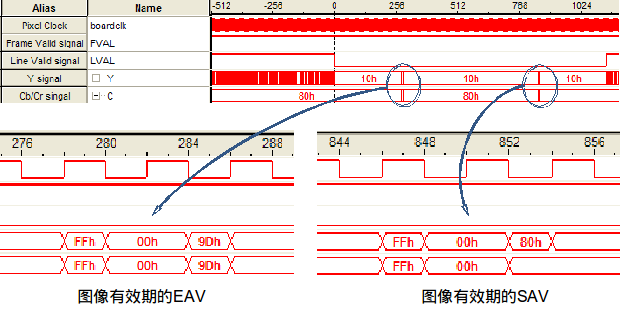

  • Hi Marvin,
        Thank you for your reply.
        You do give me a insight!  Actually, I am using an Altera Cyclone IV FPGA.  I doubt there was something wrong with my Hardward Description.  I will try to debug them out.
        By the way, in FPGA, I try to clock out my video frame at the falling edge of the sync clock.  It seems DM8168 would sample at the rising edge of the sync clock, isn't it?

  • Hi,Li
    there is no sync clock used when use embedded sync format.
    output data at falling edge of data clock is correct.
    BT1120 data format as follow:
    Y:FF0000XXDATAFF0000XX
    CB/CR:FF0000XXDATAFF0000XX
    need not CRC,and make sure data<255 ,in BT1120,data should <235,but 254 seems work well.
    Good Luck
    dv
  • Hi Marvin,
        Yes, I take advantage of the 16-bit embedded sync words (EAV / SAV), not the discrete sync signals (Field HSYNC VSYNC).
        I tried to generate such a frame by my FPGA:
        I didn't take care of the LineNumber Field and CRC Field in the timing of digital line blanking.  Actrually, these data are filled by 0x10.  But according to your words, it seems that I shall not using the digital blanking at all, shan't I?
        In other word, I think a complete line data steam is like this:
        EAV (0xFF 0x00 0x00 0xXY)  ==> ANC (272 words)  ==> SAV(0xFF 0x00 0x00 0xXY) ==> ACTIVEDATA(1920 words)  ===> EAV(Next Line) ...
        Referring to this, shall I make my line sequence like this?
        SAV(0xFF 0x00 0x00 0xXY) ==> ACTIVEDATA(1920 words)  ===> EAV(0xFF 0x00 0x00 0xXY)  ==> SAV(Next Line) ...
        Shall I leave out all the Digital Blanking Field (Ancillary data)?
    Naroah
    Mar/18/2014
  • Hi,Li
    Ancillary data i just use 1 line.L1-L41,L1122-L1125, i just use 1 line .it accord to your camera output feature.
    You are right.but  my design format (1 frame)as follow:
    EAV-anc(need not be 272)-SAV DATA
    EAV-anc(need not be 272)-SAV anc data
    i use this format.but the vip capture detect data by EAV and SAV,so if  you can generate EAV and SAV accord to your camera(hs,vs,or FVAL LVAL DE), your FPGA will output embedded sync data correctly.
  • Hi,Li
    you can use the open source SMPTE292 VHD demo to generate BT1120 data
    Good luck
    dv
  • Hi Marvin,
         Thank you for your awfully informative tips! That's very kind of you.
         Anyway, I will try to debug my Verilog HDL.
         Wish a good luck!
    Naroah
    Mar/18/2014

  • Hi Li, Hi Marvin,
    I am sorry to reply to an old post but I'm trying to make exactly the same thing as you and I don't undestand correctly what you are saying in the thread.
    First of all, Marvin, you hare saying "output data at falling edge of data clock is correct." whereas I have found in this thread :
    e2e.ti.com/.../228820
    that "DM8168 is sampling data as falling edge of pixel clock".
    In the BT 1120, it is saying that sampling is on the rising edge, so the data should be outputed at falling edge of data clock.
    I have tried both but nothing is working :)
    Marvin, you also say that ancillary data need not be 272. But can you confirm that blancking pixel need to be 272 between EAV and SAV ? Do you change EAV and SAV if the line is real image data or not ? I have undestood in the BT1120 that EAV and SAV should be :
    - B6 / AB on lines L1-L41 and L1121-L1125
    - 9D / 80 on others
    I personnaly don't need to put ancillary data, so I just fill pixel with blanking pattern but it does not working.
    Thank you.
    Franck
