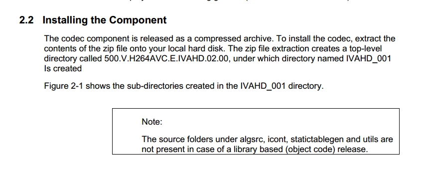

Thanks for your reply!
I am using EZSDK 5_05_02_00;I do have found the HDVICP 2.0 firmware ,but I can't find codec component and the test application as H.264 Encoder on HDVICP2 and Media Controller Based Platform User’s Guide says.
6204.H264_Encoder_HDVICP2_UserGuide.pdf
Best Regards!
Tian
In EZSDK there are demos. You could find them in /ti-ezsdk_dm814x-evm_5_05_02_00_spain/component-sources/omx_05_02_00_48/examples/ti/omx/demos.
You could find more information about the demos in OMX_05_02_00_48_UserGuide.pdf.
Shishun Tian said:,but I can't find codec component
The HDVPSS firmware is "black box". The source code is under NDA. In this case you should contact your local FAE to prove you more details regarding this.
