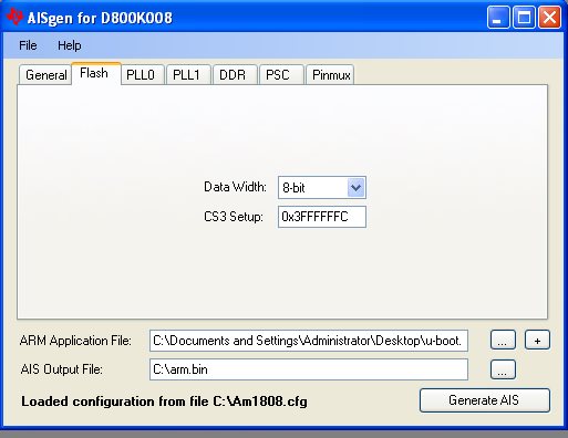

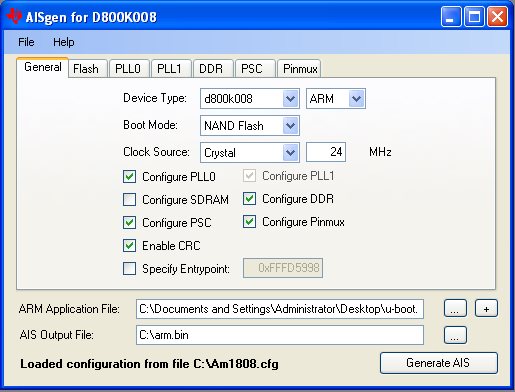

    I've read the Boot loader procedure using the UART boot Master, but i can't find the way to load Kernel in this document ? I can understand now how to create a AIS image, but i am not sure if is it correct or not !! Because every time i Load the AIS image file using UART HOST v1.3, the I/o Read error occurs.
    What things should i keep in mind while creating the AIS image ? Below are the settings i've set to generate AIS image
    I've set the
    1. Pin Mux Settings using Pin Setup Utility

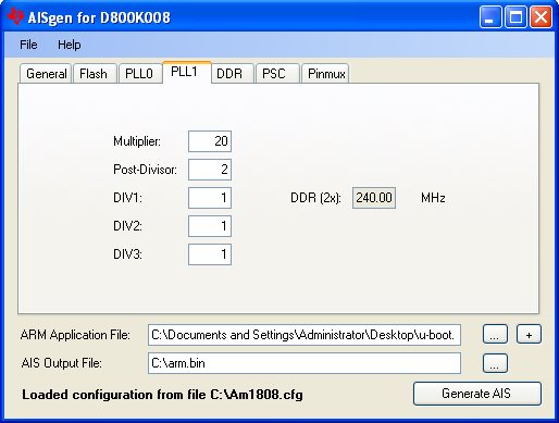

    2. PPL 0, PPL 1 Settings
      1. PPL 0:
        ARM9_0: GEL Output: |              PLL0 Information             |
        ARM9_0: GEL Output: ---------------------------------------------
        ARM9_0: GEL Output:
        ARM9_0: GEL Output: PLL0_SYSCLK1 = 24 MHz
        ARM9_0: GEL Output: PLL0_SYSCLK2 = 12 MHz
        ARM9_0: GEL Output: PLL0_SYSCLK3 = 8 MHz
        ARM9_0: GEL Output: PLL0_SYSCLK4 = 6 MHz
        ARM9_0: GEL Output: PLL0_SYSCLK5 = 8 MHz
        ARM9_0: GEL Output: PLL0_SYSCLK6 = 24 MHz
        ARM9_0: GEL Output: PLL0_SYSCLK7 = 4 MHz
        ARM9_0: GEL Output:
      2. PPL 1
        ARM9_0: GEL Output: |              PLL1 Information             |
        ARM9_0: GEL Output:
        ARM9_0: GEL Output: PLL1_SYSCLK1 = 24 MHz
        ARM9_0: GEL Output: PLL1_SYSCLK2 = 24 MHz
        ARM9_0: GEL Output: PLL1_SYSCLK3 = 24 MHz

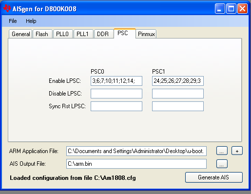

    3. PSC Settings
    I am not sure about the following settings
    1. How to set DDR2 Setting
    2. Flash Setting
    I suppose that i've to change the settings specific to my board setting ? but where can i find this information ?
    For u-boot,
    You need to convert the u-boot.bin to u-boot.ais (input file(ARM application file) as u-boot.bin)
    You need to mention DDR2 timing parameters and booting type and that parameters if NAND/SPI While you are creating AIS.
    After that write the u-boot.ais file into NAND/SPI/NOR which you configured as booting type while you are converting to AIS.
