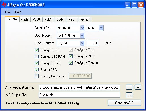

How to find the entry point when creating AIS image for AM1808.
If i do not select the Entry point check box, AISgen tool gives an error. How to find that entry point ?

The entry point for the uboot given in PSP release is 0xC10800000.

If you want to convert the u-boot.bin to AIS format then do the following,
Procedure for u-boot building:
make clean ARCH=arm CROSS_COMPILE=arm-arago-linux-gnueabi-
make distclean ARCH=arm CROSS_COMPILE=arm-arago-linux-gnueabi-
make da850_am18xxevm_config ARCH=arm CROSS_COMPILE=arm-arago-linux-gnueabi-
make u-boot.ais ARCH=arm CROSS_COMPILE=arm-arago-linux-gnueabi-
You can convert AIS format directly while compiling u-boot,
"The entry point for the uboot given in PSP release is 0xC10800000."
This is the entry point for SD/MMC Boot, Is this the same for NAND Boot ?
Have a look to my previous reply,
Yes it is.
If you build the u-boot source with AIS format then u-boot source will take care everything but configuration is matters.
