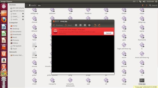

I want to interface USB camera with the omap l138 lcdk kit,, when i am connecting the camera to the kit after booting the linux kernel in the serial terminal i am getting
omapl138-lcdk login: root
root@omapl138-lcdk:~# usb 1-1: USB disconnect, device number 2
usb 1-1: new full speed USB device number 3 using ohci
usb 1-1: New USB device found, idVendor=046d, idProduct=0825
usb 1-1: New USB device strings: Mfr=0, Product=0, SerialNumber=2
usb 1-1: SerialNumber: C1D14B60

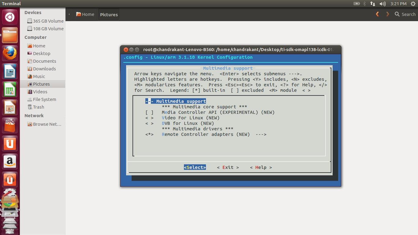

    Typically, If you got any kernel source, we have some standard steps to build,
    1) cleaning old builded files (clean & distclean commands)
    Note:
    Its one time only
    2) Do "defconfig" for your board (ex: omapl138_lcdk_defconfig)
    3) Compile kernel (this is equal to pre-built image bcz you have not changed anything)
    4) Now , Change choose the kernel drivers using "menuconfig"
    5) Recompile the kernel for latest changes (like UVC ),
    Ex:
    cd /root/ti-sdk-omapl138-lcdk-01.00.00/board-support/linux-3.1.10
    make distclean ARCH=arm CROSS_COMPILE=arm-arago-linux-gnueabi-
    make clean ARCH=arm CROSS_COMPILE=arm-arago-linux-gnueabi-
    make omapl138_lcdk_defconfig ARCH=arm CROSS_COMPILE=arm-arago-linux-gnueabi-
    make menuconfig ARCH=arm CROSS_COMPILE=arm-arago-linux-gnueabi-
    < Do the changes here >
    make uImage ARCH=arm CROSS_COMPILE=arm-arago-linux-gnueabi-
    I hope it helps.

    root@omapl138-lcdk:~# usb 1-1: new full speed USB device number 2 using ohci
    uvcvideo: Found UVC 1.00 device <unnamed> (046d:0825)
    input: UVC Camera (046d:0825) as /devices/platform/ohci.0/usb1/1-1/1-1:1.0/input/input0

  • When i had run the following commands
    then this happens

    scripts/kconfig/mconf Kconfig
    Your configuration changes were NOT saved.
    but when i am trying to change the UVC it is not coming in the multimedia option in device drivers

    now i have seen this post how to take image http://e2e.ti.com/support/dsp/omap_applications_processors/f/42/p/328619/1145565.aspx#1145565
    but when i am giving command uvccapture then error is coming
    root@omapl138-lcdk:~# uvccapture
    ioctl querycontrol error 22
    root@omapl138-lcdk:~# ls
    and when i am seeing the image by removing sd card from the kit and then connecting with computer, when i am opening the image which is in the rootfs i am getting the error,i am attaching the snap shot
    what is the problem
    You should not get any errors while capturing the image.
    It seems to be the problem of resolution of your camera,
    Try this command to capture the low resolution images.
    root@omapl138-lcdk:~#uvccapture -x320 -y240  -v
    root@omapl138-lcdk:~#uvccapture -x640 -y480  -v
    Let us know the results.
  • now this error is coming
    root@omapl138-lcdk:~# uvccapture -x320 -y240 -v
    Using videodevice: /dev/video0
    Saving images to: snap.jpg
    Image size: 320x240
    Taking snapshot every 0 seconds
    Taking images using mmap
    Resetting camera settings
    Camera brightness level is 0
    Camera contrast level is 25
    Camera saturation level is 80
    Camera gain level is -1
    Saving image to: snap.jpg
