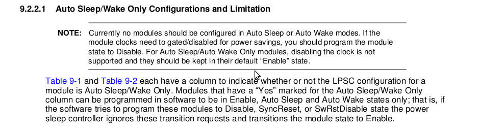

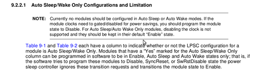

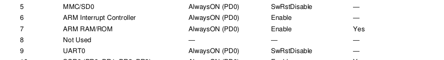

  • Hi Breeze,
    Sorry for the delayed response,
    1) ARM only able to modify the ARM RAM/ROM,
    2) If you trying to change the module state which modules supports "Auto Sleep/Wake" feature , It changes automatically to again "enable" state even you tried to change through sw,
    Please refer the chapter 9.2.2.1 in TRM,
    And also, As Mukul suggested that you ll get less amount of power saving from this module and best to choose ignore this critical module from power saving and try to focus some other module or methods for your power saving with considering your product use case,
    Definitely we support our level best,
  • Titus,
    Thank you for your help, and I am sorry I did not notice that.
    j-breeze
