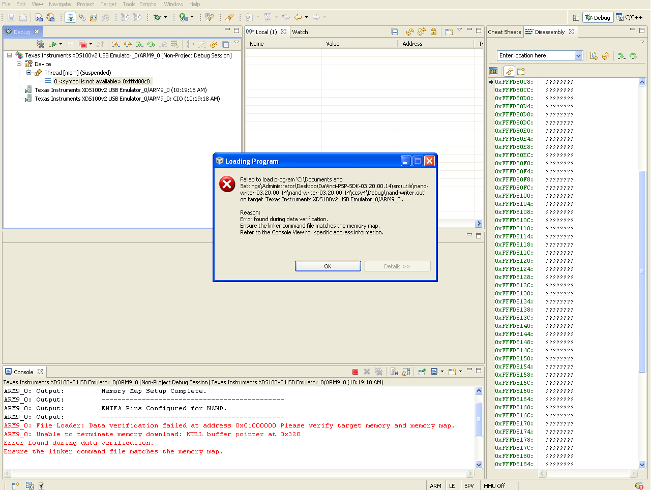

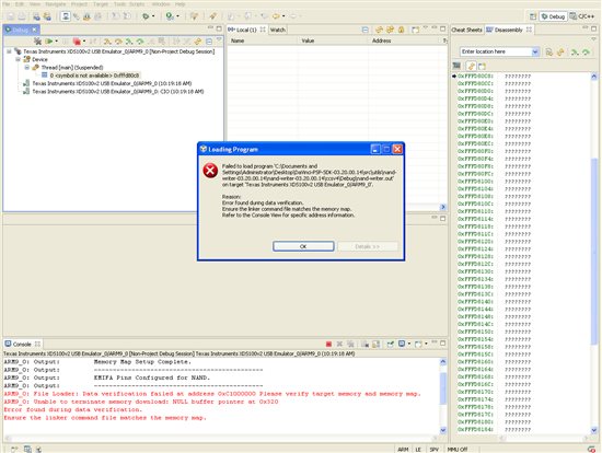

This error looks like linker.cmd issue,
Are you build this .out file yourself or pre-built one?
You need to build this nand-writer source project according to your memory mapping through linker.cmd file.
Ans. I have build this file using CCS4.

Linker.cmd

This is my linker.cmd file
i think the problem is with the RAM, if i change it or remove it. will it work then ?
I think, without RAM you can't,
If you dont have RAM then where you will execute the application?
