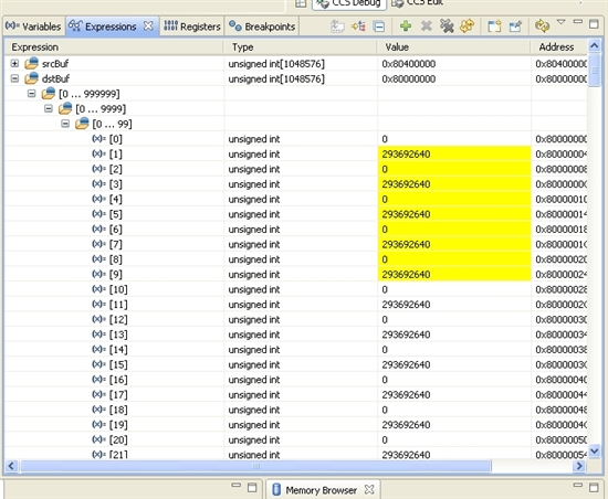

I'm using PCIe interface of C6678 DSP , for communication between two DSP "RC to EP" whit the CI2EVM_BoC dual evm interface card, I use the code PCIEexampleProject by TI. I realized a number of scenarios like Memry read and memory write with/without   common REFCLK " is generated on the BoC".
But now I tried to create a new scenario :
* RC  write data to EP
* RC Read the same data from
this scenario without common REFCLK Mrd and Mwr  is OK
but with common REFCLK just MWr is OK and MRd is NOTOK
my scrbuf[i]=i (RC)  but I find that in dstbuf(RC)
the results:
I really need to work wtih common REFCLK, help plz,

  • Hi Ganapathi, thanks for your reply again.
    yes exactly I have this problem sometimes at the writing to EP, I found just the 0....
    But why this problem when used common REFCLK.
    What can I do? this is a problem  setting in BOC or in EVMs or something else?

  • Hi Steven , thanks for your reply
    I repeated the test again and I found:
    DEVSTAT (0x02620020) -- especially PCIESSMODE[1:0]  EP(0001080B)  RC(0001880B) IS OK
    - PCIE_SERDES_CFGPLL (0x02620358) ==> yes 000001C9
    PCIE_SERDES_STS (0x0262015C) -- if LOCK field is 1 to indicate PLL is locked  is  OK  (00000209)
    - DEBUG0 (0x21801728)  EP(00004600) RC (00006700)
    - CMD_STATUS (0x21800004) -- if IB_XTL_EN is enabled on EP  is  OK and OB_XLT_EN is enabled on RC is OK
    On RC side:
    - OB_OFFSET_INDEX0 (0x21800200)   = 70000001
    - OB_OFFSET0_HI (0x21800204)  = 00000000
    On EP side:
    - IB_BAR0 (0x21800300)  = 00000001
    - IB_START0_LO (0x21800304) = 70000000
    - IB_START0_HI (0x21800308) = 00000000
    - IB_OFFSET0 (0x2180030c)  =  0C000000
    - BAR1 (0x21801014) = 70000000
    ==> RC outbound translations (70000000) match with EP inbound translations (70000000
