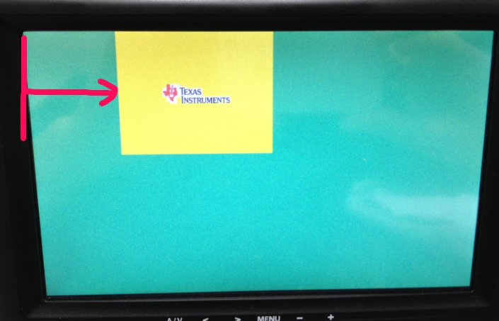

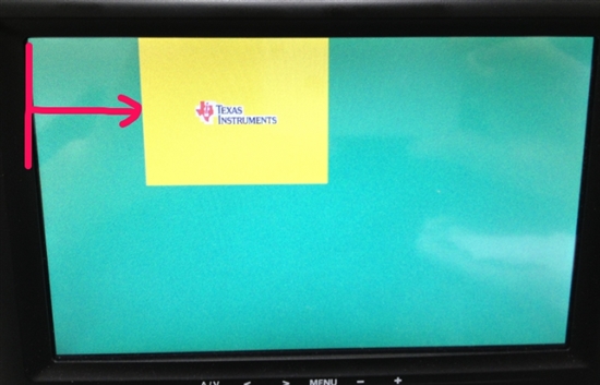

Load 1920*1080 (for 1080p) and 1280*720 (for 720p) bmp 24bits to display.
Q1: For 1080p, the screen shoule flash, but 720p don't.
Q2: For 1080p & 720p, the image show at screen, the image is shift at Horizontal or Vertical.
How to slove the flash and shift issue?
Thanks a lot.

    I tried internal color bar, the screen is always  right.
    Q1. I am change Venc h_front_porch from 88 to 256 as below, then the screen does not flicker/ flash..
    From : configVenc(0x6000, 0x2, argv[0], 1920,  88, 148,  44, 1080, 4, 36, 5);
    To : configVenc(0x6000, 0x2, argv[0], 1920,  256, 148,  44, 1080, 4, 36, 5); >> but this is inconsistent with the specification
    Q2. I make sure WIDTH and HEIGHT that are correct, but shift is always there.
    Q3. How to set the pixel clock (148500 or 74250) to cup register, the u-boot do not description this?
    { VDIS_TIMINGS_1080P_60, 148500, 1920, 88, 148,  44, 1080, 4, 36, 5 }
    { VDIS_TIMINGS_720P_60,   74250, 1280, 110, 220,  40,  720, 5, 20, 5}
    Thanks a lot.
