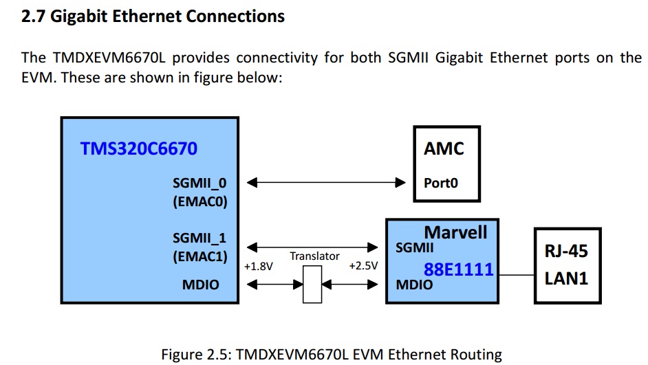

how can i activate SGMII0 and SGMII1 with using client.c(the NDK sample)
Other Parts Discussed in Thread: TMS320C6670
Hello.
I use unknown EVB based on TMS320C6670.
The EVB has two ethernet Phys(Both SGMII0 and SGMII1 can be connected to network).
So I want to use both ethernet ports.
I used client sample as an NDK sample. However the sample uses only SGMII1.
I tried something to activate two ports in the sample. But I failed.
What should I do more?
Now, I modified somethings,
    1. add following line in main() to make sure SGMII0 is connected to phy.
        emac_port_mode[0] = PLATFORM_EMAC_PORT_MODE_PHY;
    2. modify section for creation of configuration like following.
