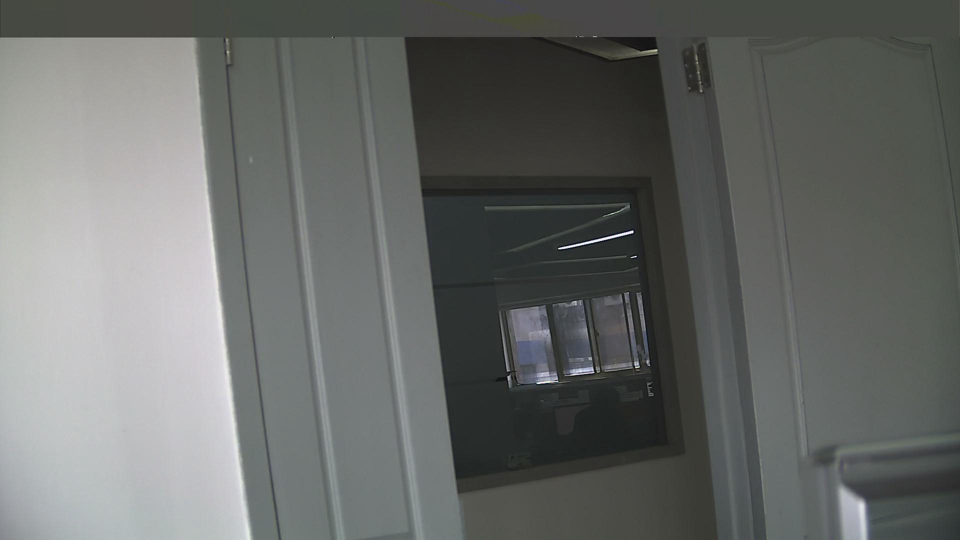

our platform is ezsdk 5_05_02_00,we use v4l2 driver to capture 1080p25 video from portB of VIP0,some picture in the video have problem,show as attachment
what can cause this problem?

Hi David,
1)we use our application based on v4l2 capture and omx component, like this
v4l2 capture(video4) => nf => omx_h264enc => omx_h264dec => scaler => v4l2 display(video1)
2)as i said,it's from port B of VIP0, which is 8-bit
3)video from camera 1080p25
thanks.
What is the interface that you are using to connect your decoder to the VIP? If it is discrete sync capture, vip could capture horizontal and vertical blanking infromation that you will need to crop either in the scalar or in the application by offsetting the start address.
Rgds,
Brijesh
