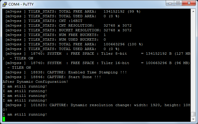

    I am now employing EVM8168 + Custom FPGA for developing.  I have successfully made the whole system working.  The FPGA would generate dummy BT.1120 1080p video frames and feed them into the VIN0 Port of DM8168 within a 8bit x 2Bus embedded sync mode.  And we also tried to display the captured video onto a HDMI monitor.
   FPGA: 1080p BT.1120 @54MHz  ==VIN0 Port===>  Capture(1080p60) ===> Disp(1080p60)
   The usecase run perfectly for three days.  However, the usecase could not capture the dummy video frame immediately, after I powered off and restarted the EVM8168 (cold restarting).  The monitor would display a blank background and the usecase never posts any error or warning on my terminal.
     Fig 1.  The monitor display nothing but a blank background once I run my usecase.
      And yet I just let the usecase run.  Three minutes or 5 minutes later, the terminal would post
 [m3vpss ]  101823: CAPTURE: Dynamic resolution change: width: 1920, height: 1080!
     and I could see the colorbar (my dummy video frames) displayed on my monitor.
    Fig 3. After 3~6 minutes, it would be able to display my dummy video.
    I don't know why DM8168 cannot capture my video frames immediately after I starting the usecase.  Yet if I don't try a cold restarting but a hot restarting, I could see my colorbar once the usecase has been run.
    So, could you please help me to solve this issue?  I have no idea with this scenario.

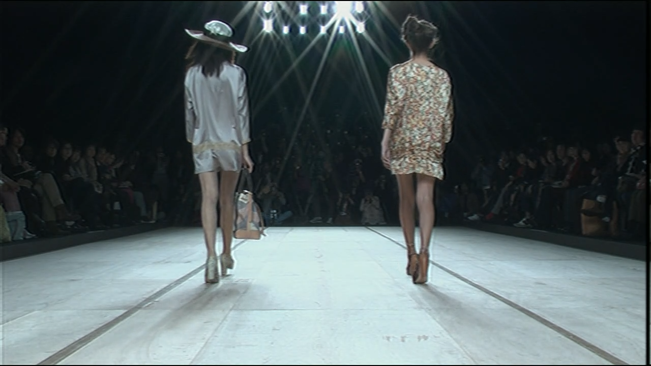

        By the way, I have your usecase tested.  I could see nothing except the TI logo, which was stamped by OSD, in my monitor.  The background of my monitor is black.  I am not sure about the availibity of your video source, since I could not display the video with my usecase (only the TI logo), either.
        I tried to open your H264 video by employing KMPlayer.  It seems perfect.  I would try to modify your .ini configuration file and hope a better result.
       Fig 1. I could see the video frames by employing KMPlayer

  • Under what condition does your application send LinkControl cmd CAPTURE_LINK_CMD_SET_RESOLUTION.
     Sending that cmd will result in print "CAPTURE: Dynamic resolution change: width: 1920, height: 1080"
    It seems on restart your capture source doesn't start sending data.
    You can confirm this by invoking Vsys_printDetailedSTatistics and checking the capture statistics to see if you receive any frames or not when you are seeing blank dispaly
