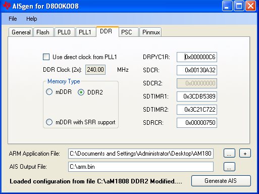

  • My Target Device is AM1808 not AM1810.
  • Can you tell me step by step procedure to Modify the files?

    It seems to you no need to change anything because by default it exist for your requirement such as UART2, 24MHz ref freq, 16 bit bus data width for OMAPL138_LCDK board and others(AM18xx) 8 bit , etc.
    You have to match the DDR parameters for your board.
  • Where can i find my DDR parameters ?
    Refer the below location in serial flash utility source code.
    OMAPL138/Common/include/device.h
    extern __FAR__ Uint32  DEVICE_ExternalMemInit(Uint32 ddrphycr, Uint32 sdcr, Uint32 sdtimr, Uint32 sdtimr2, Uint32 sdrcr, Uint32 sdcr2);
    Refer your DDR data sheet and modify DDR parameters (registers such as SDRCR, SDCR,SDCR2,SDTIMR,SDTIMR2)  in below mentioned sections (shaded color for your AM1808 processor.)

  • Is this ok ?
    // Timings for mDDR at 150 MHz
          status |= DEVICE_ExternalMemInit(0x000000C6, 0x00130A32, 0x3CDB5389, 0x3C21C722, 0x00000750, 0x00000000);
