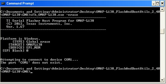

Connection Error while erasing NAND using Serial Boot
Other Parts Discussed in Thread: OMAP-L138, OMAPL138, AM1808, AM1810
How can i change the settings of Serial Boot tool for my custom board.
The board connect on COM17 and has a NAND Flash.

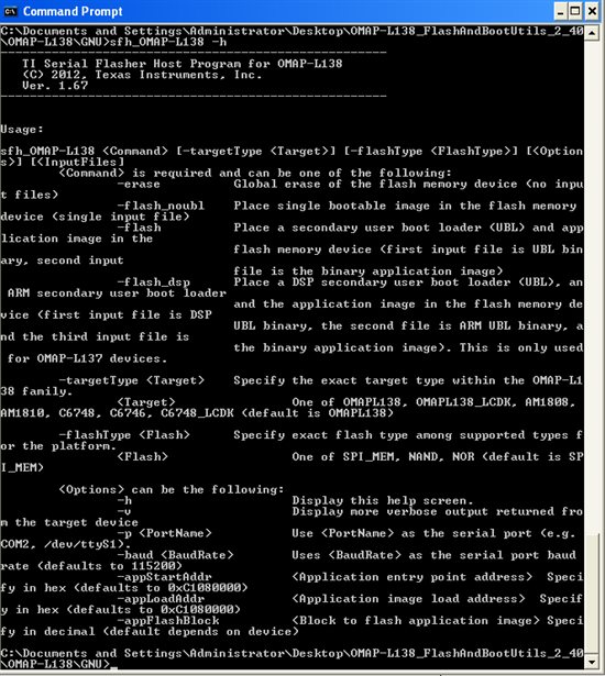

    The sfh_OMAP-L138.exe can take following options,
    -targetType         : Specifies exact target type within OMAP-L138 family (default OMAP-L138)
    -flashType          : Specifies exact flash type (default SPI_MEM)
    -p <COM PORT NAME>  : Allows specifying com port other than default 'COM1' or '/dev/ttyS0'.
    -h                  : Show help text.
    -v                  : See verbose output from target device
    -baud <BAUD RATE>   : Allows specifying baud rate other than default (115200)
    -APPStartAddr       : Changes entry point of application (default 0xC1080000)
    -APPLoadAddr        : Changes load address of application (default 0xC1080000)
    -APPFlashBlock      : Changes the block to flash the image into (only for no_ubl mode)
    So in your case to change the COM port use -p option (-p COM17)

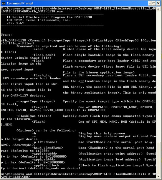

    I am not sure which version of flasher you are using if you can just type 'sfh_OMAP-L138.exe -h' or 'sfh_OMAP-L138.exe' on the command prompt it will list out all the options If you can post the output of this command I can confirm you.
    --Prabhakar Lad
  • Same Error. I guess i am not writing the correct command
    1: Can you post what command you typed ?
    2; Can you post the output of by only jsut typing 'sfh_OMAP-L138.exe' ?
    --Prabhakar Lad
    • sfh_OMAP-L138.exe -p COM17
    • sfh_OMAP-L138.exe -flashtype NAND
    You need to give following command (Assuming its on COM port 17)'
    sfh_OMAP-L138.exe -erase -flashType NAND -P COM17
