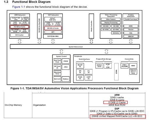

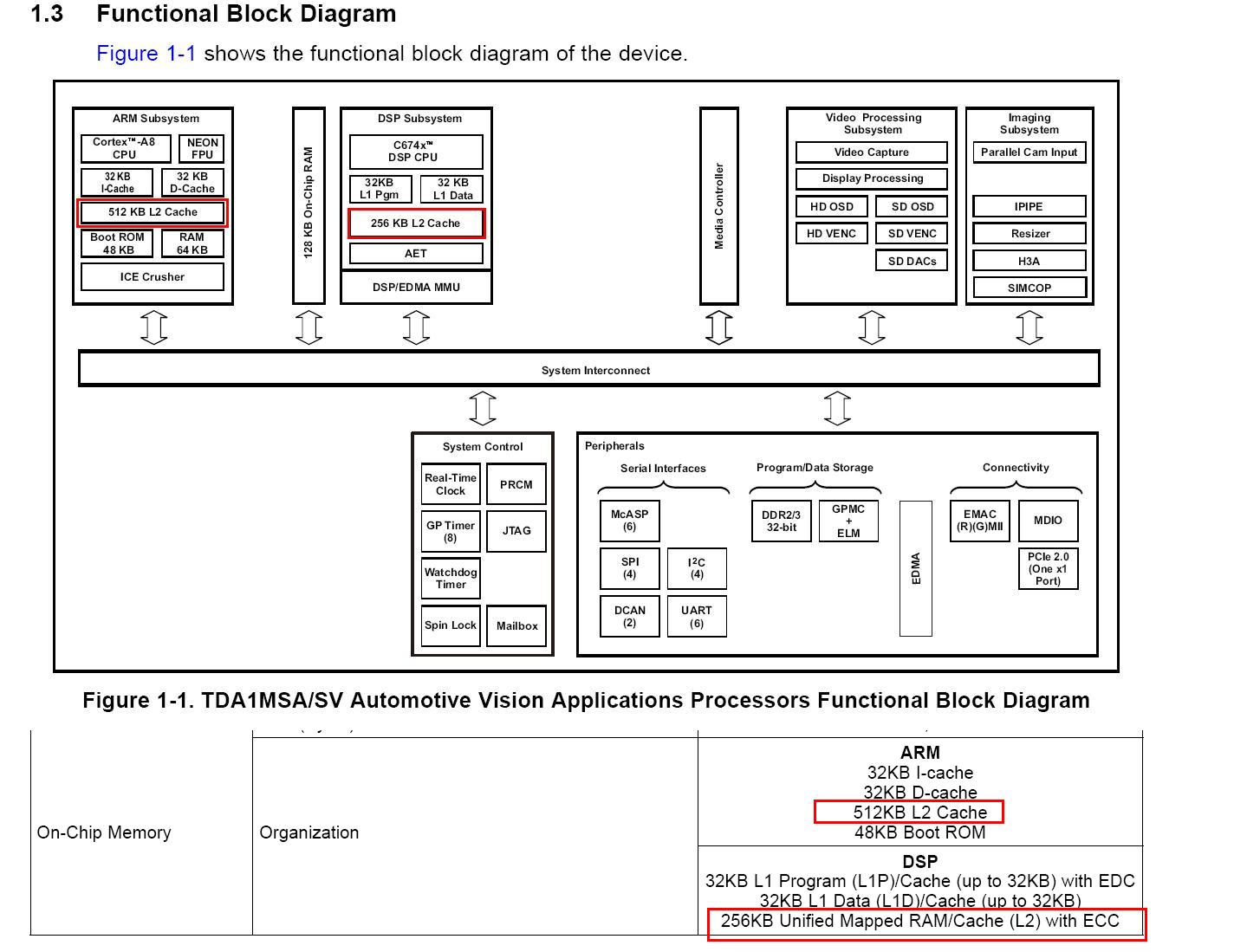

When processing images on A8, I may need to use on-chip memory (L2) to speed up the performance.
Could A8 512K L2 be used as a SDRAM for DMA+PingPong Processing just like in dsp?
Is there register or memory map to do the job?
  • Joey,
    No, I do not think you can use the Cortex-A8 L2 cache as RAM for DMA transfer. The DSP L2 is stated as cache and/or RAM and is mapped at start address 0x40800000/0x00800000, while Cortex-A8 L2 is stated as just cache and no start address is available in the Memory Map.
    See also this E2E thread:
    http://e2e.ti.com/support/dsp/davinci_digital_media_processors/f/716/t/243883.aspx
    There is RAM inside the Cortex-A8, mapped to start address 0x402F0400, but I think you can not use it for a DMA transfer as this RAM is small in size (64KB) and stated as internal for the Cortex-A8 (only accessible by the Cortex-A8).
    Certainly.  You can use L2 Cache Lockdown to effectively turn part of L2 cache into local RAM (in steps of 1/8-th of the total L2 cache), and then use the PreLoad Engine (PLE) to move data in/out of cache in the background while you process the previously loaded data in parallel.
    More information can be found in the ARM Cortex-A8 Technical Reference Manual, specifically section 3.2.54 for the details of cache lockdown, section 8.4 for an overview of the preload engine and sections 3.2.59-3.2.67 for its details. Useful background info is also in the ARMv7-A/R Architecture Reference Manual, for example section B.2.2 on caches in general.
