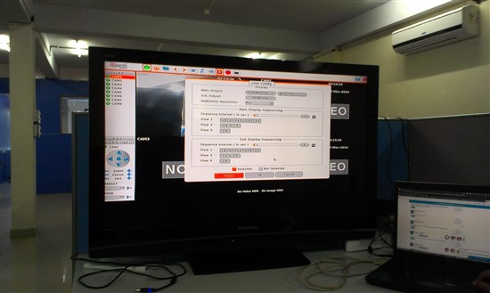

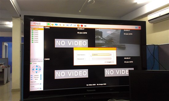

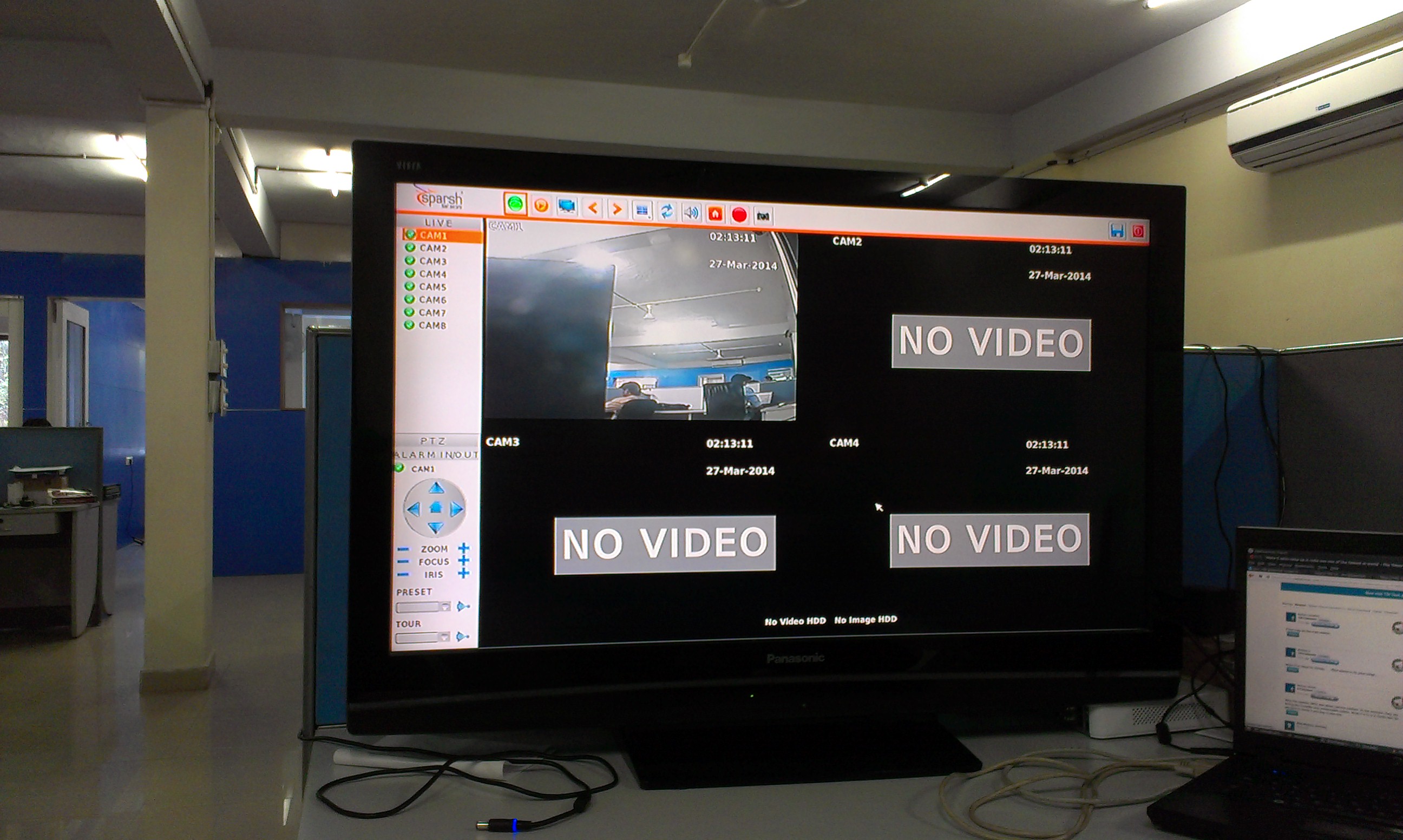

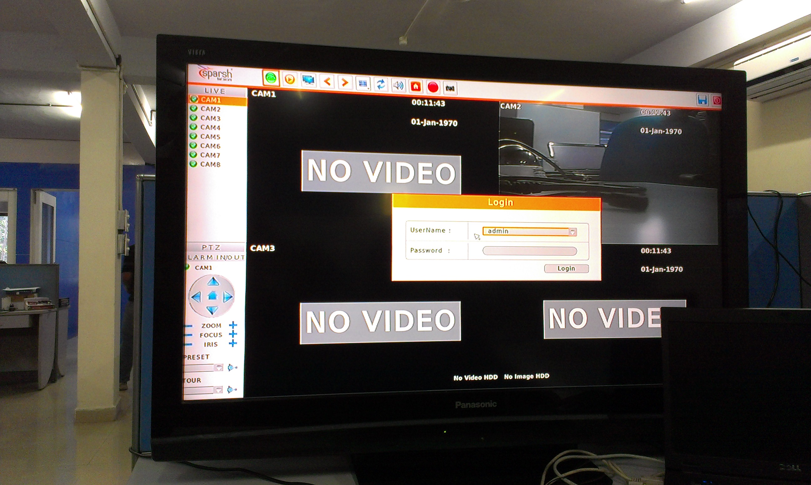

      We are using DVRRDK 3.0 frame work (DM8107) and we need to support the PAL in SD display out (TVout). RDK support is there but its not working properly.  Display got shrinked from the bottom when we put the standard as PAL. Even when i tried changing the display timings in vps/hal/src/vpshalSdVencDefaults.h , its not getting effect eventhough the sysfs shows the set value properly. Any way the clock value is not from that structure its from the kernel i suppose.
drivers/video/ti81xx/vpss/dctrl.c
What modifications should i try if I want to play with some timings/clocks in the display controller so that I get a properly rendered pal signal in the TV
  • Hi Faizel,
    Can you first enable internal color bar and see if it working fine? if it works fine, there is issue in the timing.
    Rgds,
    Brijesh
          If possible can you tell me how to enable the colorbar? Any RDK support?
    Faizel
  • Pls confirm that that VdisParams resolution for SD display is set to PAL and not NTSC before you do Vdis_init.Also check in your usecase file that displayPrm.resolution is set to PAL for SD display.
    After confirming these changes pls share logs of Vsys_printDetailedStatistics
  • Hi Badri,
                     Thanks for the response. I checked both the places and its pal. But the irony is that for  my display NTSC is fine. So when running this PAL settings I have changed the display standard through mcfw api (for that logs have attached). How to proceed here?

  • Hi Badri,
                     Thanks for your response. I am not suspecting anything from the video side and our encoded stream is OK. We have graphics enabled for tv out is also showing the same issue. And regarding the tv detection I don't think my tv is properly detecting the signal as PAL. Even if I force the TV to PAL its showing the same. But in the case of NTSC its OK.
    From the figure you can notice the shrinking in case of PAL Standard.
    Any clue
    Faizel

  • Can you switch off grpx completely and check the video alone is cropped or not
    echo "0" > /sys/devices/platform/vpss/graphics0/enabled
    echo "0" >/sys/devices/platform/vpss/graphics1/enabled
    echo "0" >/sys/devices/platform/vpss/graphics2/enabled
    confirm you don't see any gui after disabling grpx.
           I have done experiments with the demo mode and found that in the demo there is some crop in the video itself from the edges of almost all sides. For PAL mode that crop is more.  The issue which I faced earlier (shrink from bottom) was happening on run time change of the resolution, when i put the change on system start i am not getting the shrink from the bottom issue. But left side is cropped out. I have tried disabling the graphics but the video itself is cut from sides. Now how should i move further. I have attached the new snapshot
    Cropped (left) display
    Not Cropped (see left).
    May be I can adjust the GUI start location by varying the graphic start pixel in PAL case. But we want to narrow down the issue here. Any help is appreciated.

  • This could be TV overscan .Do you have option to force underscan in the TV ?
  • From the picture you have shared, it looks like somewhere it is downscaled to 480 lines, it does not look like overscan issue. Is your capture source NTSC or PAL? Are you enabling scaling in grpx? Can you check what is output size in grpx?

  • Hi Brijesh,
                       Thanks for your time. Hope you are referring to the second set I have shared.  First problem i am able to avoid when I stopped the run time switch (now only boot time switch).
    Faizel
  • Hi Badri,
                      I have checked the overscan also. Its in off mode. The output is still the same.
    Faizel
         Any more update here. Shall I need to cross check the fbdevice first or the display driver for PAL. Do I need to suspect the timings? If so how to tune the display parameter?
    Faizel
            I could control some of the parameters by changing the timing structure in the file vps/hal/src/vpshalSdVencDefaults.h.  But till now it didn't solved the problem that left side video is little cropped vertically. I could change the relative start position of the video. If i change the start position then the crop will come on the right end. Please comment on how to reduce the active video size to fit in a PAL screen
    Faizel
  • Hi Faizel,
    Have you checked the internal color bar and saw that it is also shifted output? If the color bar output is not shifted, then it is not the issue in the timing information. You will need to check somewhere in the pipeline to see who is giving incorrect frame. May be you could even try dumping frame before enqueueing it to the display driver and check if it is correct.
