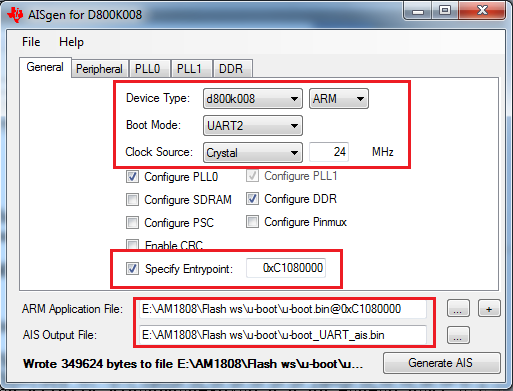

      I'm using the AM1808B processor and its derived from OMAPL138_LCDK board.
I did the following procedure.
1. Built the u-boot from u-boot-2010.12-psp03.21.00.04.lcdk and got u-boot.bin
2. Open the AISgen_dd800k008_install_v1.13 and File --> Load Configuration --> OMAPL138_LCDK_AISGen_Config.cfg
I've uImage and file system in SD card so u-boot_UART_ais.bin boot successfully and its booted the Linux kernel and file system successfully because i can see the USER LED blinking in heartbeat trigger.

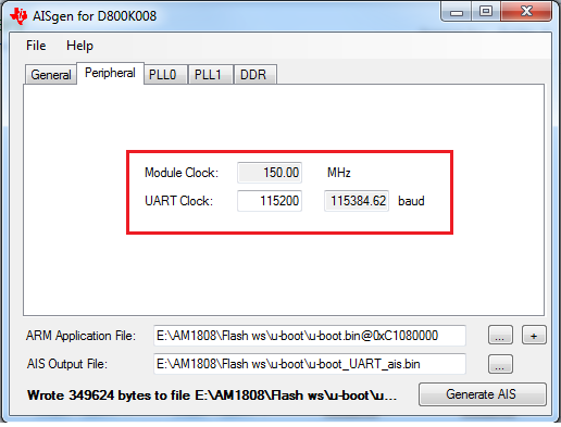

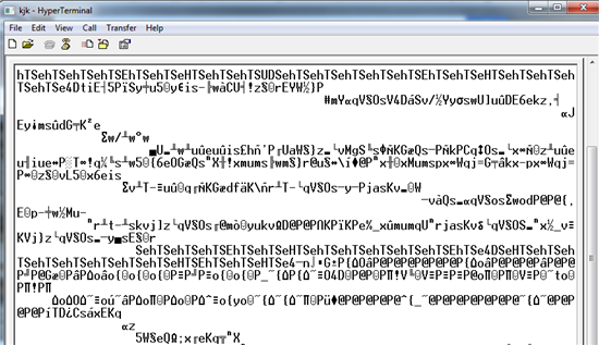

When i open the Hyperterminal in windows the logs are not proper because of baudrate mismatch.
Baudrate  : 115200
Data bits  : 8
Parity        :  None
Flow control : None
Please let me know how to fix the UART clock for proper baudrate.
