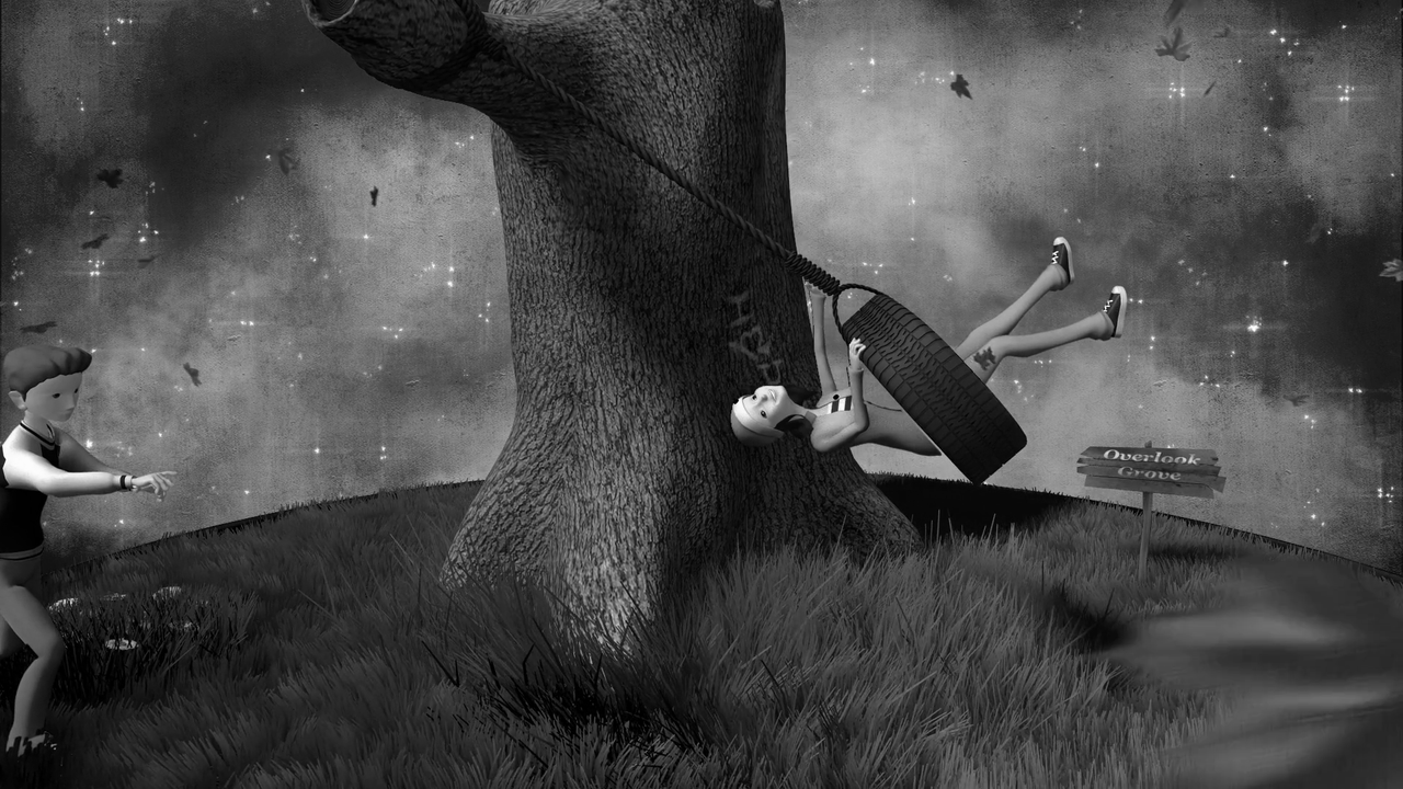

I use the DVRRDK 04.00.00.3 on a EVM8168 plateform.
I use the Link API to create custom application that can capture raw video at 720p.
My use case is :
TVP7002 --> CAPT (1Ch 720p60) --> IPCFRAME OUT RTOS --> IPC FRAME IN HLOS --> file.
My goal is to do snapshot uncompress.
The format out off capture is set to YUV422I_YUYV.

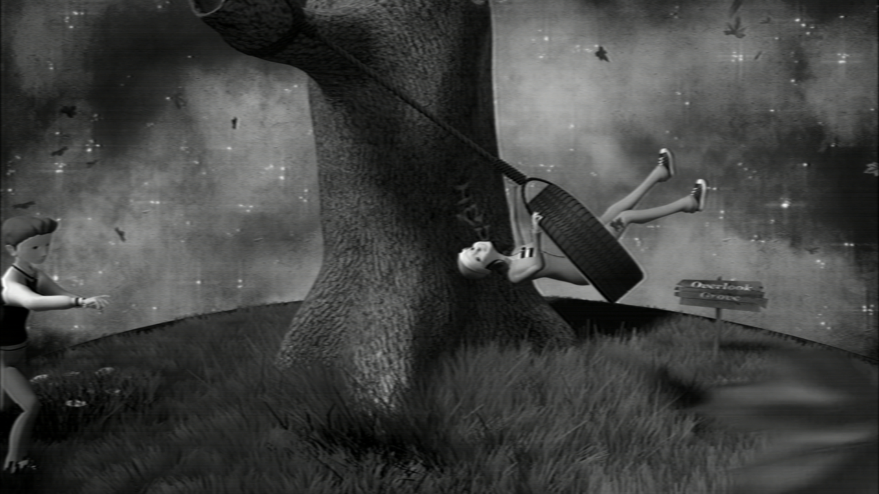

But I have a problem about the quality off the capture.
When I compare the image source and the result image, there is a big difference ?
I don't undestand why.
Is it a tvp7002 configuartion problem or the configuration on the VPSS ?
I attach 3 files, the bmp source, the bmp generated from the uncompress capture and the configuration that I use for the tvp70002
The  source picture :
The uncompress picture
The configuartion file off tvp7002

We can see on the uncompress picture , that the details (grass and tree bark) are becoming blurred.
Have you an idea of the source of the problem ?

  • When capture format is YUV422I as in your case the contents received in the video input parser is directly written to memory with no processing. The fact that this captured image shows artifacts indicates issue with TVP7002 configuration. Pls see this post where similar artifacts was rootcaused to external video decoder configuration although the fix was not shared is not useful for you

  • Hi Badri,
    Effectively, I have found the problem.
    It is not the TVP the problem but the configuration of the THS7368 that is connected in front of the TVP7002.
    The bandwith which was applied was 9.5MHZ for the SF channels.
    I have modified it to apply a bandwidth of 72MHz and the picture quality is very best.
    Thank you for your help.
    regards
  • Thank u for rootcausing and sharing the solution
