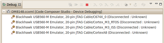

  • Qiuxicj,
    qiuxicj MESSN said:
    3 lauch selected configurations
    What do you have after this step in the CCS Debug window? I am using Blackhawk USB560M emulator, and I have the below:
    qiuxicj MESSN said:
    4 tools -> GEL files -> load GEL files 5 run -> connect target files
    Which GEL file exactly you are using? To which target exactly (CortexA8, Cortex_M3_ISS, Cortex_M3_RTOS, C674X_0, other) you are connecting? Are you executing some scripts from the GEL file before trying to connect to the target? Are you aligned with the below wiki page?
    http://processors.wiki.ti.com/index.php/TI81XX_PSP_Flashing_Tools_Guide
    Pavel
  • qiuxicj MESSN said:
    hardware version: TMDXEVM8148
    qiuxicj MESSN said:
    Board or Device TI814x
    Can you also try to select "EVMDM8148" instead of "TI814x" from the Board or Device drop down menu.
    BR
    Pavel
