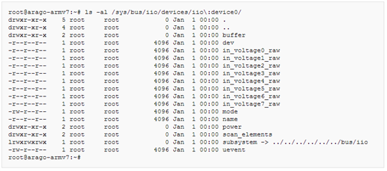

  • Nik,
    The .dtb file has to be "made" from inside the linux kernel main folder with "make am335x-boneblack.dtb" or "make dtbs"; or from inside the main SDK folder with "make linux-dtbs" as you already found out.
    Here is the AM335x ADC Driver Guide: http://processors.wiki.ti.com/index.php/AM335x_ADC_Driver%27s_Guide
    Continuous mode support has been added some releases ago, so it should be available. To enable it do:
    echo continuous > /sys/bus/iio/devices/iio\:device0/mode
    At the bottom of the ADC Driver Guide page there is a sample user space application. Please take a look at it.
    Miroslav

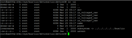

  • Miro.
    Unfortunately mode along with other options shown in the guide are missing altogether. Here's what the Driver's Guide says I should see:
    Here's what I actually see with the .dts code you gave me a couple of posts up.
    As you can see I don't have buffer, mode, and scan_elements, how do I make those appear on there?
    Nik
  • Nik, the documentation for the new SDK is still in the process of being released and all the information I have about the changes is the source code itself. From looking at the ADC driver it seems like continuous mode support has been removed and the ADC Driver Guide has not been updated yet.
    You can compare the old and new drivers to see what the changes are. The old SDK adc driver is <linux_dir>/drivers/staging/iio/adc/ti_adc.c and the new SDK adc driver is <linux_dir>/drivers/iio/adc/ti_am335x_adc.c.
    I'm sorry for not being able to give you a consistent answer, but I'm waiting for proper documentation too.
    I'll try to ask the factory team for more information on why the continuous mode has been removed and update you as soon as I can.
    Miroslav
  • Hi again, Nik,
    Just got a response from the factory team. Here is a link to the SDK 7 ADC information: http://processors.wiki.ti.com/index.php/Sitara_Linux_SDK_ADC
    Please check the ADC interface known issues page. Unfortunately continuous mode is not supported and currently there is no schedule for it.
    Miroslav
