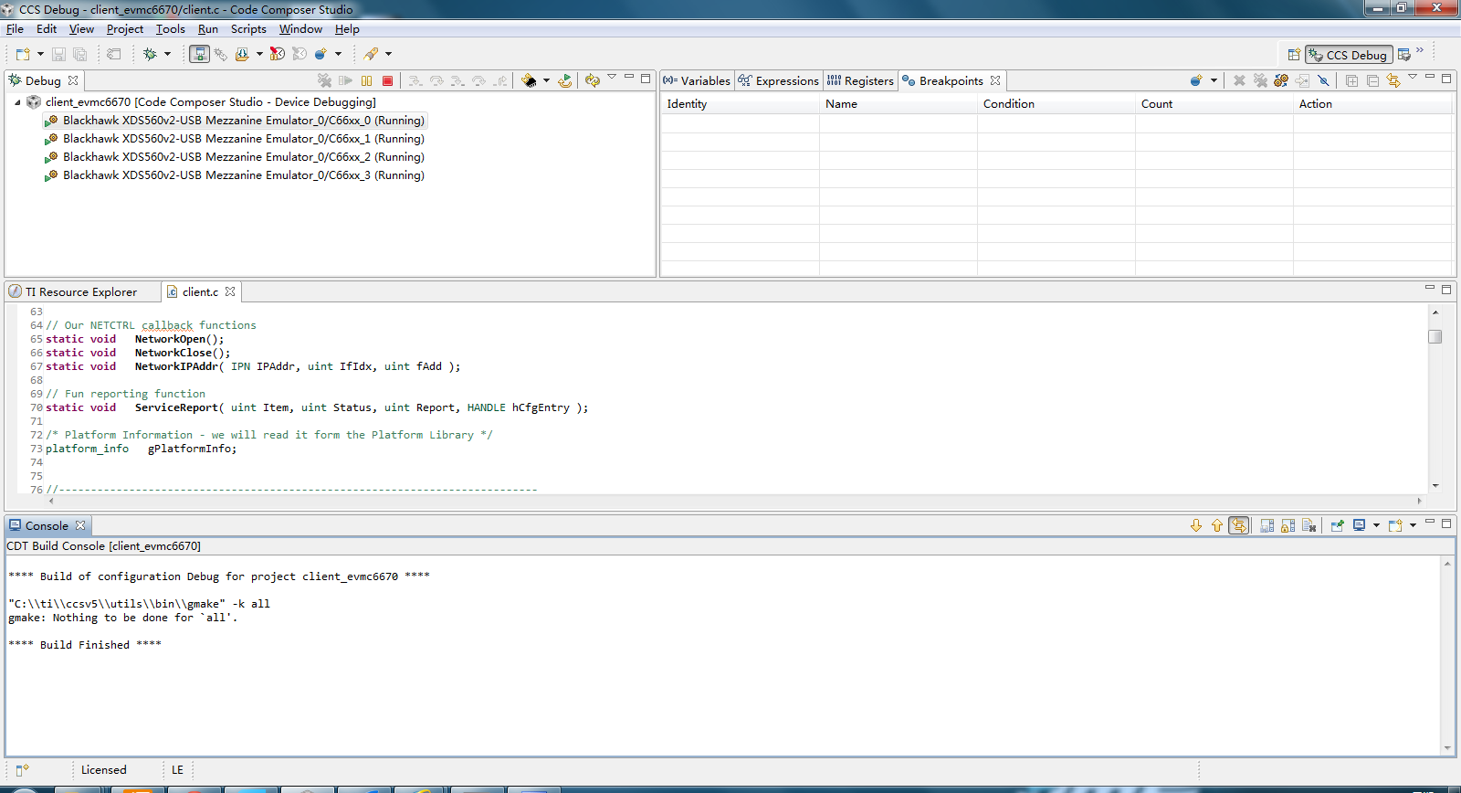

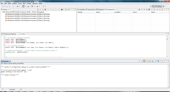

    Thank you fou your reply! As your direction,I found the client example project ( C:\ti\mcsdk_2_01_02_06\examples\ndk\client) and import it to CCS,and the program can be running.like the following picture:
    But why there has no output from the console?what can I do to capture the IP packet from the Ethernet?I found someone in the forum said we must allocate an IP address for the DSP board and then use Wireshark to capture the packet,Is that right ?what should I do?

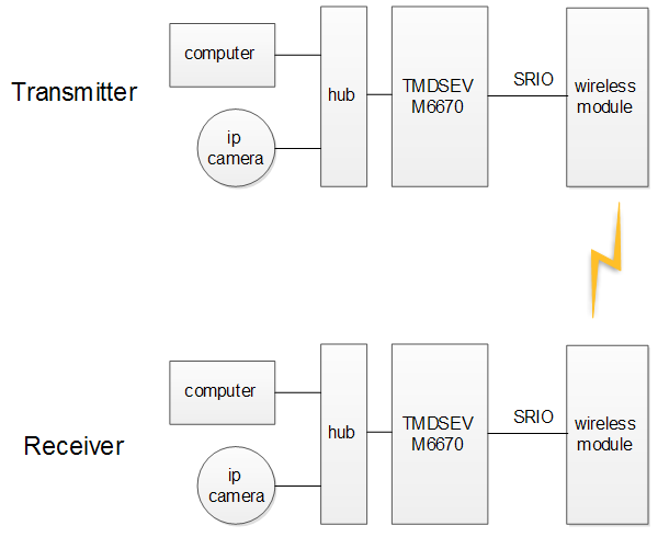

    Let me explain what we want to do in our  work.We are trying to build a wireless communication system  based on TMDSEVM6670.I'd like to show you in the following picture:
    So in the transmitter,we need to capture the video packets from the hub and then send the message to wireless module by SRIO;in the receiver,we capture the packets from SRIO and then send them to the hub.So I actually need a procedure to  achieve our goal.

  • Hi Alex,
    thanks for the detailed overview of your system. The best way to get it running is to understand the examples!
    This is what you have to do.
    I suggest you start with the reciever part of your system, because you can test Ethernet Transmitter first with wireshark or similar program.
    In the example the interessting part is what core0 is doing.
    ----- Multicore Navigator part --------
    Initializing Free Descriptors.           <- reserve memory for buffer pointers in descriptor of queuing system
    QMSS successfully initialized        <- Queue Manager Subsystem
    CPPI successfully initialized          <- Communications Port Programming Interface (Packet DMA)
    ----- Ethernet part --------
    PASS successfully initialized                                          <- initialize packet accelerator (Register, also PacketDMA)
    Ethernet subsystem successfully initialized
    Tx setup successfully done                                             <- here TX part is done
    Rx setup successfully done                                            <- later you need also RX part
    PASS setup successfully done
    Try to understand all parts of this example to get ethernet TX and later RX running.
    By the way, I think there was a error. Maybe try to make a full system reset when you start this program.
    <VerifyPacket: Byte 40 expected 0x1d, found 0x18>
    (This could be happen when you start your program twice or start another program with another configuration for network coprocessor!!!)
    List:
    1. reserve Memory for pointers in Host Descriptors of queuing system in shared memory
    2. init QMSS/CPPI so that you are able to create Descriptors and put them into Queues and use Packet DMA
    3. init PASS (prepare network coprocessor for queuing system with internal Packet DMA)
    4. init SRIO (prepare serial rapid io for queuing system with internal Packet DMA)
         I think it is also possible from the picture view.
         Also try to understand flow concept of Descriptors so that SRIO take a descriptor from a free descriptor queue and put it to the input queue of the network coprocessor for automatic TX your payload.
    use also TI Traning Videos
    memory
    interface
     Best regards
    Mehly
